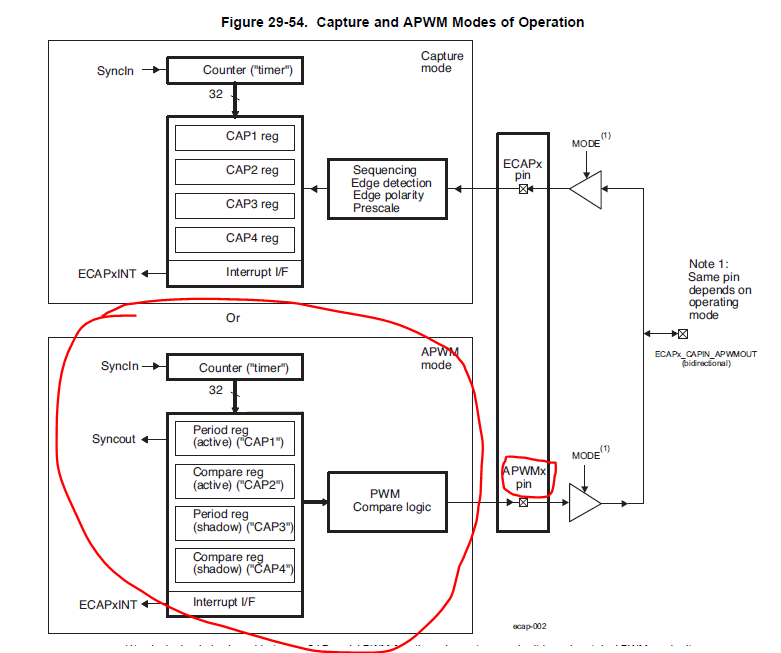

I'd like to use GP Timer5 (A18 on AM5708) to generate PWM signal from Linux.
Is Timer 5 part of the PWM subsystem in Linux? I am confused because technically it is a timer, not a PWM output.
Also how do I configure the device tree to enable Timer 5?
  • Ok here is an update:
    After setting "status" to "okay" for timer5 in the DTS, I can now enable "pwmchip2" in /sys/class/pwmchip2. This creates "pwm0" in /sys/class/pwmchip2/ as well.
    Is "pwm0" my timer 5?

    The goal is to use Timer 5 on Am5708 to output PWM for a period of time.

  • Based on the sysfs operations you included, the eCAP module (configured in APWM mode) of the PWMSS is being used.  Therefore, configuring TIMER5 shouldn't have any influence on the eCAP operations.
    The devices tree should have entry
    &ecap0 {
    status = "okay";
    To enable pwm0 you'll need to perform the following write:
    echo 1 > /sys/class/pwm/pwmchip0/pwm0/enable
    Note: PWM outputs will be driven on the pins corresponding to ECAP0 configured in APWMx mode.
