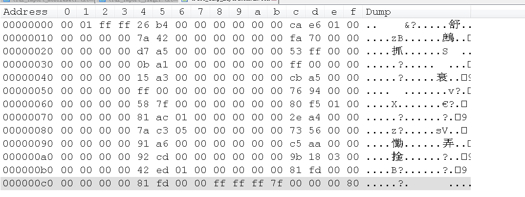

    I have import tool to import network model, and I get some .y files and a .bin file.
    1、What dose it mean that "overlay code", how can I do to overlay code?
    2、How to understand the bin file, is it the result file, but I can not understand it?
    The accessory is the bin file for import jseg21 net.
    Overlay code is a simple C code which will read this output bin file and overlays the segmentation output on top of input to visualise the segmentation ouptut.
