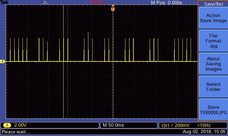

   I am Using PROCESSOR-SDK_RTOS-AM572x - pdk_am57xx_1_0_8 .I am running TI-RTOS on DSP core. I have written a abstraction layer for my slave FPGA Sitting on SPI3CS0, While doing single spi transaction multiple times in a loop, I am seeing  some spi transactions are missing. I went through the driver the code is in proper sync with data sheet. I wonder why I am facing this inconsistent SPI transactions. Clock is in PHA0POL0 with a speed of 1 MHz and CS is in active low state.

      I have tried MCSPI example in loop, I have attached the Image from the oscilloscope.I am doing a single transaction multiple times with a delay of 10 ms, I probed the sclk line, I can see some transaction missing.
    I above Image The time between two cursor is 10 ms, Which is proper but In below Image the time between two cursor is 38 ms i.e some transactions are missing in between.
    I can clearly see some transactions are missing between the two cursors.

    Can you elaborate the two pics you posted? To me it looked the same, one group contains 3 spikes of SCLK. In the first pic, you measured the gap of the 2nd and 3rd spike in the SAME group, it is 10ms. Then, in the 2nd picture, you measured the gap between 3rd spike of a group to the 1st spike of the NEXT group, it is 38 ms? If you do the same measurement, it is also 10ms in the second group. Or 38ms in the first group.
    Regards, Eric
  • Hi Eric,
         The expected capture from the oscilloscope is continuous spikes with a 10 ms delay in between, But some spikes are missing as seen from the pictures. There are no groups of spikes  in above pictures,The second picture signifies that there is transaction miss in between, when I measure the delay between 2 spikes in between in the second picture it is 38 ms( as shown by cursor ) which should be 10 ms which clearly signifies there are 2 transaction miss in between. I have attached the snippet of the code.

    Currently I am trying with a blocking mode of transfer, The captured above pictures are for blocking mode. When I changed it to callback mode I am seeing more transaction miss than blocking mode.
