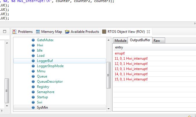

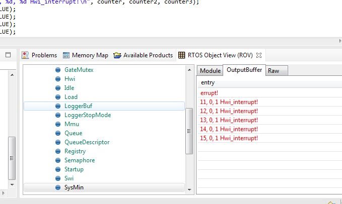

  • I realized SWI was generated only 1 time, and thus I modified my source to have SWI_post in the HWI in below.
    test_Swi2.zip
    But, SWI was not generated in this case, and the result is as below.
    in above SysMin buffer, middle '0' should be changed whenever SWI was generated as I increased counter as below.
    Please let me know how I can resolve this issue and successfully generate SWI.
    Void myHwiFxn(UArg arg)
    Hwi_clearInterrupt(5);
    counter++;
    Swi_post(LEDSwi);
    System_printf("%d, %d, %d Hwi_interrupt!\n", counter, counter2, counter3);
    AppDelay(DELAY_VALUE);
    Void mySwiFxn(UArg arg)
    counter2++;
    System_printf("%d Swi_interrupt!\n", counter2);
    Thanks and Best Regards,
    SI.
    I resolved this. I seemed there was no time gap for SWI to be active.
    When I used timer, this issue was resolved.
