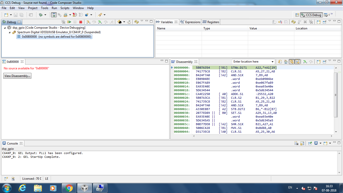

Hi
Thank you for the reply. I was able to solve that issue by including lib file in linker. But now I am facing new problem. I am not able to debug the code. and simple hello world program which I was able to load is
suddenly not able to connect to target. If I manually connect also its getting stuck. Showing no source available.
Hi
Thank you for the reply. I solved the issue by adding .cmd file.
Is it necessary that we add the linker.cmd file to project? and If in future I use custom board can I use the same linker.cmd file provided for DSK6455
