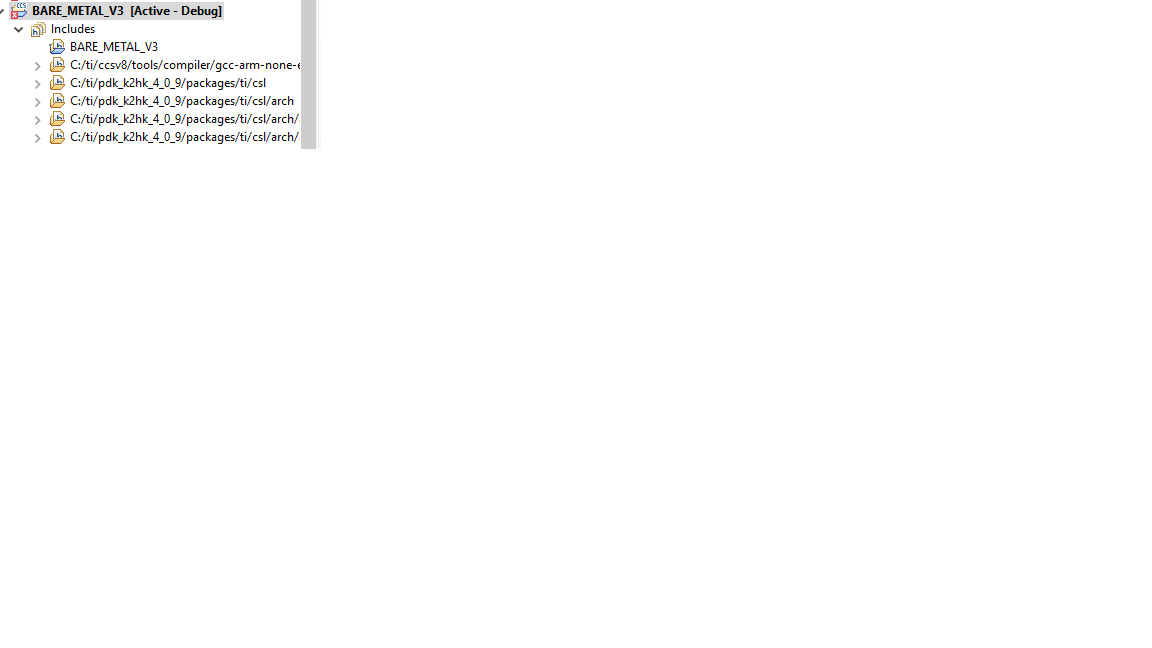

Hey all,
I know this might be a bit of a dumb issue but i cant figure out how to properly add CSL / references into my baremetal project. My CCSv8 installation does not have the hello world example in bare metal that the example projects i read online easily compile, nor does the workstation I use have an internet connect. I'm not sure if the hello world project comes with the correct CSL paths to the project. How would you add the CSL into your project starting from scratch, starting with nothing but a main function.
It doesn't make sense why CCS wouldn't see the .h files if they are included in the search paths. Is there a setting somewhere that I missed? Also how would I reference the .C files that go along with the appropriate modules for the CSL. Mainly interested in using the Arm Processors
Here are some screenshots of my set up along with output from the compiler
Build Output:
**** Build of configuration Debug for project BARE_METAL_V3 ****
"C:\\ti\\ccsv8\\utils\\bin\\gmake" -k -j 8 all -O
Building file: "../main.c"
Invoking: GNU Compiler
"C:/ti/ccsv8/tools/compiler/gcc-arm-none-eabi-7-2017-q4-major-win32/bin/arm-none-eabi-gcc.exe" -c -mcpu=cortex-a15 -mtune=cortex-a15 -marm -mfloat-abi=softfp -mfpu=vfpv4-d16 -I"C:/Users/Freddy/workspace_v8/BARE_METAL_V3" -I"C:/ti/ccsv8/tools/compiler/gcc-arm-none-eabi-7-2017-q4-major-win32/arm-none-eabi/include" -I"C:/ti/pdk_k2hk_4_0_9/packages/ti/csl" -I"C:/ti/pdk_k2hk_4_0_9/packages/ti/csl/arch" -I"C:/ti/pdk_k2hk_4_0_9/packages/ti/csl/arch/a15" -I"C:/ti/pdk_k2hk_4_0_9/packages/ti/csl/arch/a15/V0" -g -gdwarf-3 -gstrict-dwarf -Wall -specs="nosys.specs" -MMD -MP -MF"main.d" -MT"main.o"  -o"main.o" "../main.c"
subdir_rules.mk:9: recipe for target 'main.o' failed
../main.c:1:10: fatal error: ti/csl/csl.h: No such file or directory
 #include <ti/csl/csl.h>
compilation terminated.
gmake: *** [main.o] Error 1
gmake: Target 'all' not remade because of errors.
**** Build Finished ****

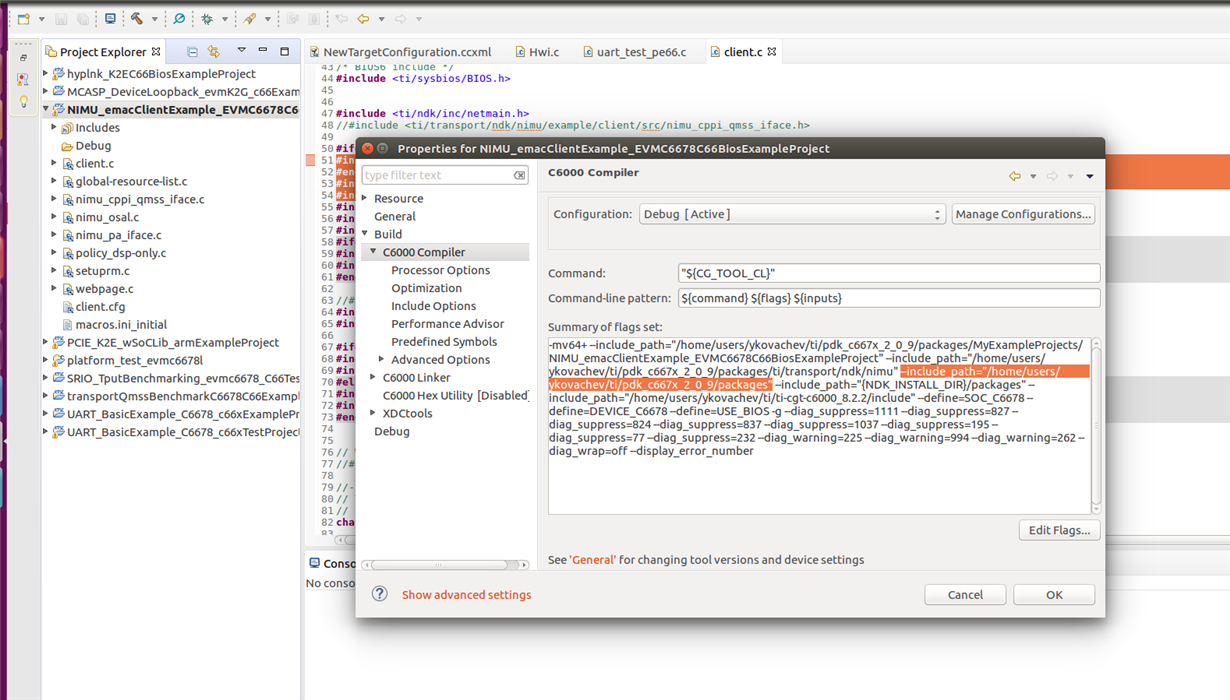

Here are the includes that are present in my compiler flags.

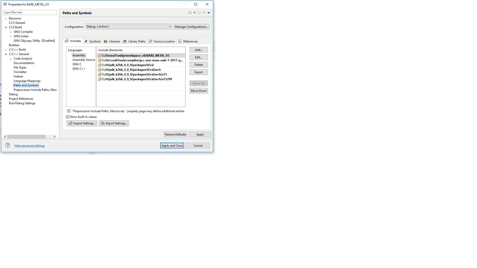

 This is what i added on the general to add the paths to the flags
    When building with CCS you first need to make sure that the pdk's packages folder is included in your projects paths. Select the project -> choose properties and check the include paths:
    Once you make sure you have the paths set. You can include the CSL headers as follows:
      #include <ti/csl/csl_chipAux.h>
      #include <ti/csl/csl_psc.h>
      #include <ti/csl/csl_pscAux.h>
    and so on.
    You can edit the include paths by clicking the Edit Flags button.
    Yordan
  • Thanks for the reply, I added only the packages root to my path, but now I'm getting new errors. Its the erros that say undefined reference to (function name), any ideas on why this is happening?
    GNU Compiler Flags:
    -mcpu=cortex-a15 -mtune=cortex-a15 -marm -mfloat-abi=softfp -mfpu=vfpv4-d16 -I"${PROJECT_ROOT}" -I"${CG_TOOL_INCLUDE_PATH}" -I"C:/ti/pdk_k2hk_4_0_9/packages" -g -gdwarf-3 -gstrict-dwarf -Wall -specs="nosys.specs"

  • Alfredo,
    There are several issues with your setup that I would like to address:
    1. It appears that you uses hello world from CCS Template and then started adding files to the code. can you confirm?  I noticed that you have startup_ARMCA15.S and 66AK2Gxx.lds which is only included if you start using the CCS template.  Can you confirm ?
    2. There are some rules that we require users to follow when including CSL libraries.
    a. Define the symbol SOC_K2H in the project. in make file this translates to -DSOC_K2H
    b. Include folder pdk_<device>_<version>\packages.
    b. Link the libraries pdk_<dveice>_<version>\packages\ti\csl\lib\<device>\<core>\release. In this case the libraries are located at :
    For exmaple : pdk_k2hk_4_0_9\packages\ti\csl\lib\k2h\a15\release
    • ti.csl.aa15fg:  this contains all CSLr and functional CSL functions and startup code.
    • ti.csl.init.aa15fg : This contains all the initialization functionality like cache, MMU and supervisor functionality
    3. Include headers files in the source with path relative to pdk_<device>_version\packages using \t\csl\<path to header>
    A good example to see how bare-metal code is built using CSL would be to look at the SBL (secondary bootloader) check out the makefile here:
    You can also look at CSL examples or test code but they may not all apply to your soc/device.
    Rahul
  • I am not working off a template, I am using Bare metal and these files are needed, unless I am wrong.
    This worked! I can see the function calls now

    Added These Libraries
    ti.osal.aa15fg
    ti.drv.gpio.aa15fg
    ti.drv.gpio.profiling.aa15fg
    ti.csl.aa15fg
    ti.csl.init.aa15fg

  • Update:
    I changed GPIO_init_v0() to just GPIO_init() and the same error came up, didn't change the anything, i added some missing libraries because the GPIO references then i think, anyway here's what I added
    osal,
    uart
    board
    i2c
    Still getting that error, and i know that the GPIO library is included, Perhaps i am missing another Define somewhere?
