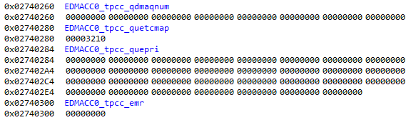

  • Mukul,
    They played with different combinations of the priority, no change in the issue.   The conclusion is the existing setting is the optimal.
    Here is the DMAQNUM register dumps.

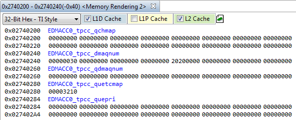

  • Hi Lawrence
    I am looking for DMAQNUM register values , which is offset 0x240.
    As you can also see quepri is set to all 0's which , which means all TCs are at equal and highest priority
    What you are showing is QueTCMAP , which we know is default Q0 to TC0 , Q1 to TC1 etc
    Mukul
  • Here is the correct register dump
    I also reconfirmed they tried different priority scheme but having them all the same worked the best overall.
  • Hi Lawrence
    Thanks. This does confirm DMA to QNUM mapping.

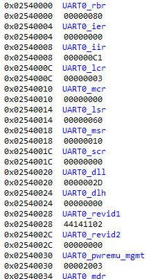

  • Mukul,
    Customer already have UART and EMIF16 receive buffers are in L2 internal memory
    I will ask them to provide a register dump for UART when the transfer are suck and your last 2 questions.

  •  UART Register dump:

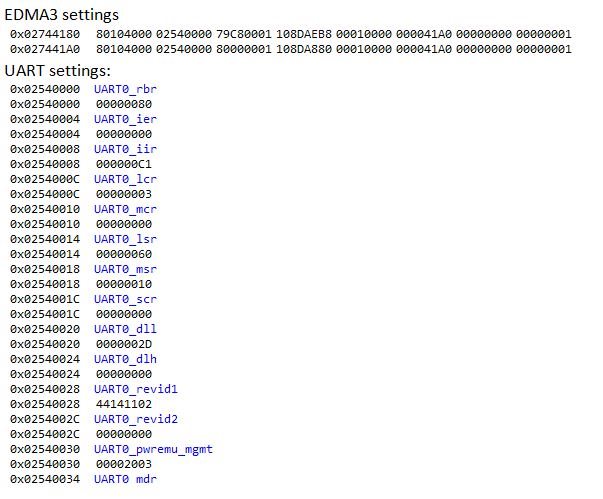

  • How the UART RX DMA is triggered? As per the above configuration, SRC is UART0 RBR, destination is L2. Once the channel using Param set 9 is triggered, it will trigger the channel using param set 10 continuously as it is linked to itself.
    Can you try the EDMA channel triggered by RX event when the FIFO reached to certain level?

  • ACNT = 1 and BCNT = 0x8000 with A-sync, SRC in incremental mode. DST in incremental mode. Given SRC is FIFO with 16-bytes depth, I do not understand use of incremental mode. Why BCNT = 0x8000?
  • Raja,
    Answers to your questions:
    How the UART RX DMA is triggered? As per the your register  configuration, SRC is UART0 RBR, destination is L2. Once the channel using Param set 9 is triggered, it will trigger the channel using param set 10 continuously as it is linked to itself
    >Customer continuously trigger DMA using link reload and circular buffer.
    >Yes, FIFO is triggered at 1 byte level.
    ACNT = 1 and BCNT = 0x8000 with A-sync, SRC in incremental mode. DST in incremental mode. Given SRC is FIFO with 16-bytes depth, it is not clear the use of incremental mode.
    >For UART received register address, both INC or CONST works the same
    Why BCNT = 0x8000?
    >this is the size of circular buffer.
