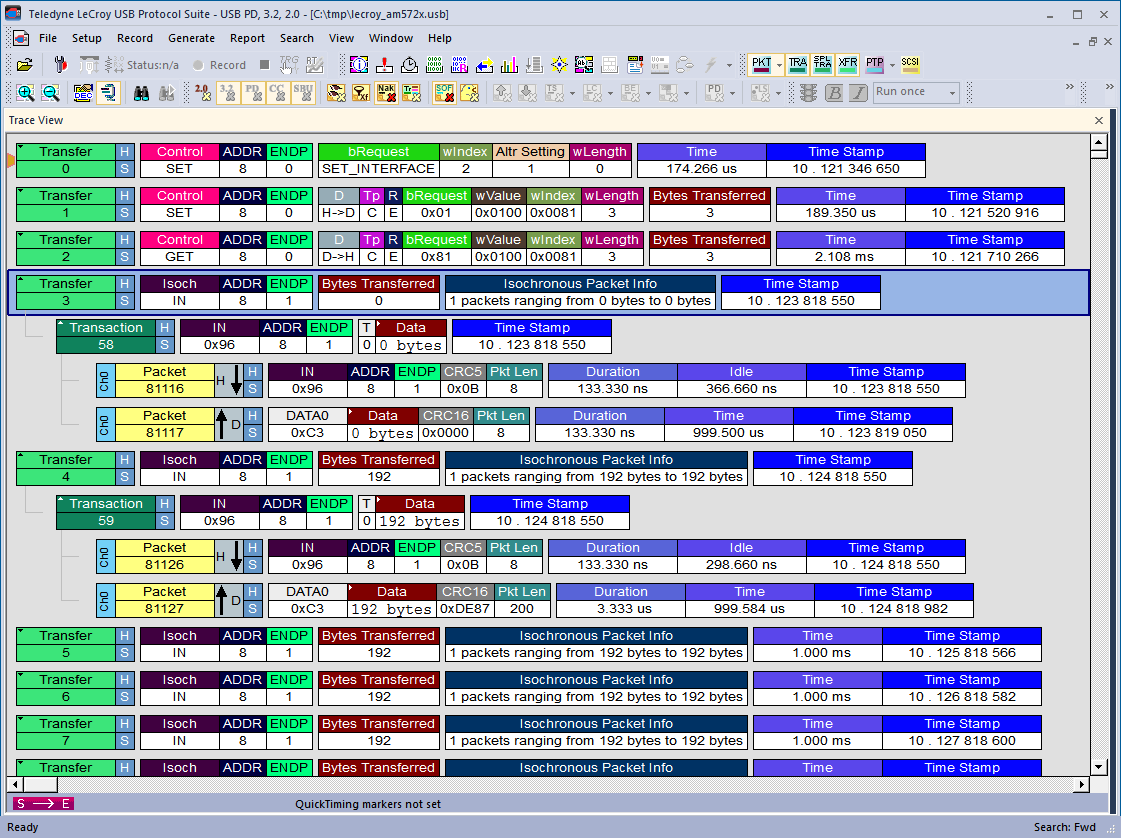

    The difference between AM335x and AM572x when the arecord is started on the HOST PC is as shown in the attached image.
    Only arecord is starting on the host PC, and no aplay is executing on the gadget side(AM335x/AM572x).
    Captured with USB Protocol Analyzer:
    For AM335x
    For AM572x
    In AM335x, the 192 bytes are transmitted at the beginning.
    In AM572x, the 0 bytes are transmitted at the beginning.
    I think that this behavior in AM572x is normal, because the transceiver should respond the Isoch IN tokens with 0-byte packets if there are not data ready yet.
    Is this correct?
    Is there a way to erase this 0-byte data packets?
    Yasun
  • Yasun-san,
    I confirm your observations - the very first Isoch packet from am335x is 192 bytes, but it is 0 byte from am57x. As you said, they are both normal from the perspective of Isoch transfers, but I am not sure if that is the case for UAC too, since the details of USB functions (such as UAC) are out of my support scope and I didn't read the UAC Spec.
    But it seems the 0-byte packet doesn't have any side effect, is there any reason why you want to remove it?
  • Bin-san,
    The reasons are:
    - Problems may be occurred depending on the host side driver and application.
    - Want to identify correctly the error conditions. (should be transferred with the expected data sizes at the normal conditions.)
    Yasun
  • Yasun-san,
    I quickly read through the UAC 2.0 Spec, but didn't find any information of specifying non-zero Isoch packet for audio streaming, so I believe the first 0-byte Isoch packet on AM57x is legal, then I have no reason to request the kernel community to eliminate the first 0-byte packet.
    Regarding your reasons, since transferring 0-byte Isoch packets is not an error condition, the host side driver should already handle it properly.
