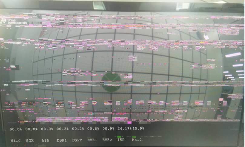

I'm evaluating LDC feature of iss simcop. There is noisy image as below and no LDC effect when LDC is enabled.
The LDC lut header file in vision_sdk\apps\src\rtos\iss\src\sensor\iss_tables\iss_tables_ldc_lut_1920x1080.h in vision sdk is used. Camera is  OV2775 TIDA1130 Sensor on Fusion Platform (Only on TDA2px)
Is there my mistake or a problem in sample lut header file?
Thanks.
My only changes at vision sdk 3.3 were
■ vision_sdk\apps\src\hlos\adas\src\usecases\iss_capture_isp_display\chains_issIspSimcop_Display.c
    pAppCtrlIssPrms->issSensorInfo.simcopOpMode =
        ISSM2MSIMCOP_LINK_OPMODE_LDC;  // ISSM2MSIMCOP_LINK_OPMODE_MAXNUM;
    pUcObj->IssM2mSimcopPrm.channelParams[0u].operatingMode =
        ISSM2MSIMCOP_LINK_OPMODE_LDC; // ISSM2MSIMCOP_LINK_OPMODE_VTNF;

■ bypasLdc = FALSE, LDC lut is default

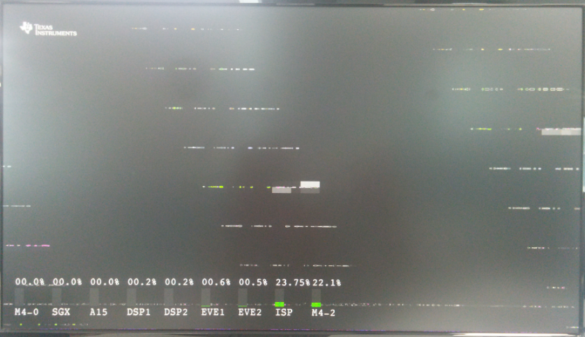

■ bypasLdc = FALSE, LDC lut is filled with '0x00'

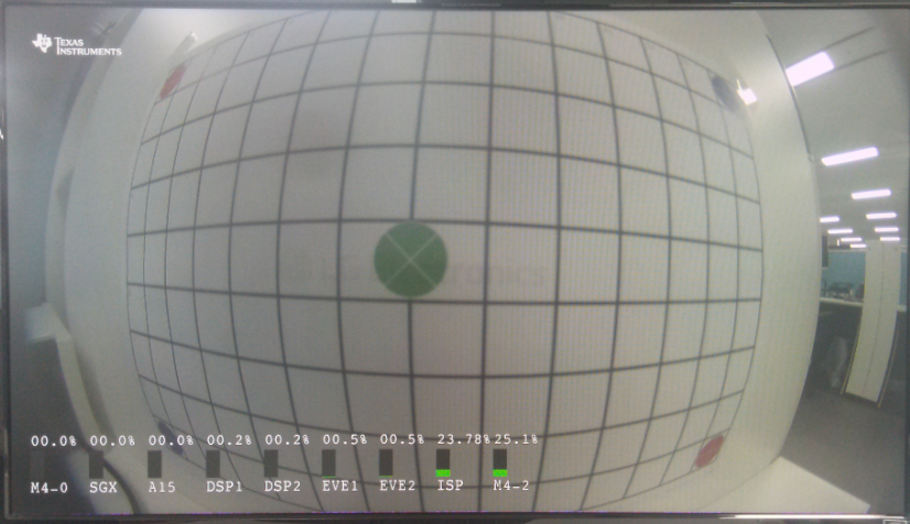

■ bypasLdc = TRUE
