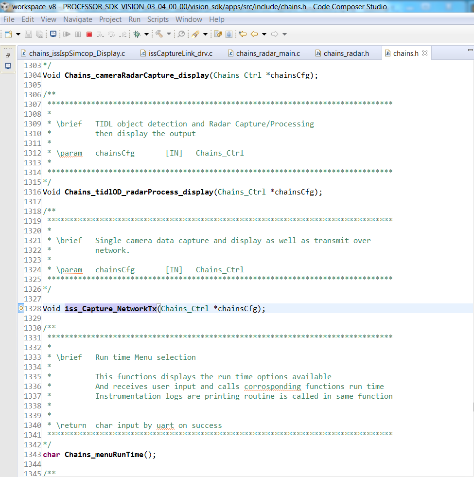

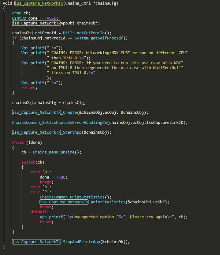

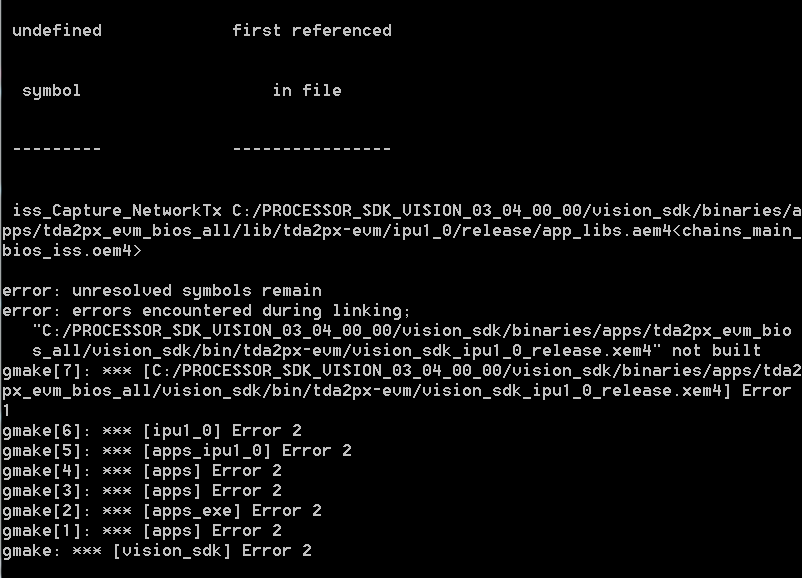

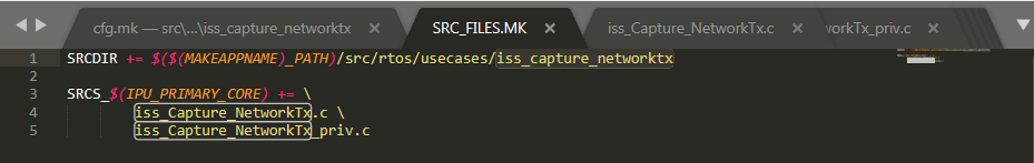

    I generated the corresponding c and h "priv" files with the use case generation tool, wrote the main c file based on the chains_networkTxCapture and chains_issIspSimcop_Display usecases, and debugged the compile errors. However, now I am stuck on a linker error I can't seem to figure out.
    Here is the command prompt output:
    It complains that my function can't be found. However, in the chains.h header file included in the chains_main_bios_iss.c file, my function is declared:
    My function is defined in my main c file:
    And I have also added the c files for my usecase to their corresponding make file:
    Is there something I've missed for the linker to be able to resolve my function?

  • Hi Prasad,
    I realized I forgot to include the auto-generated h file in my main c file, so I did that and also renamed my usecase files, functions, and variables to have the "chains_" prefix to keep the same convention as the standard usecases. However, I still get the same unresolved symbols error.
    Richard
  • Hello Richard,
    Did you confirm if your new use-case is getting buit?
    1. Please add some error in the use-case main file and see if it is caught by the compiler.
    2. Check if use-case is shown in the enabled use-cases in the "gmake -s -j showconfig"
  • Hi Prasad,
    I can now build and run my use case. However, I am now facing runtime issues. Since those are pretty far removed from the original topic of this thread, I have started a new thread here:
