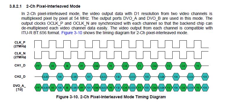

Hi all,
    Refer to TVP5158 datasheet, as figure below shows, in pixel-interleaved mode, all channel data will interleave together, include SAV/EAV code, so obviously, it's not standard BT.656 format. Does DM365 vpfe support this format? If yes, what shoud be modified in DM365_DVR_DVSDK3_00.02.00.00. Thank you!
