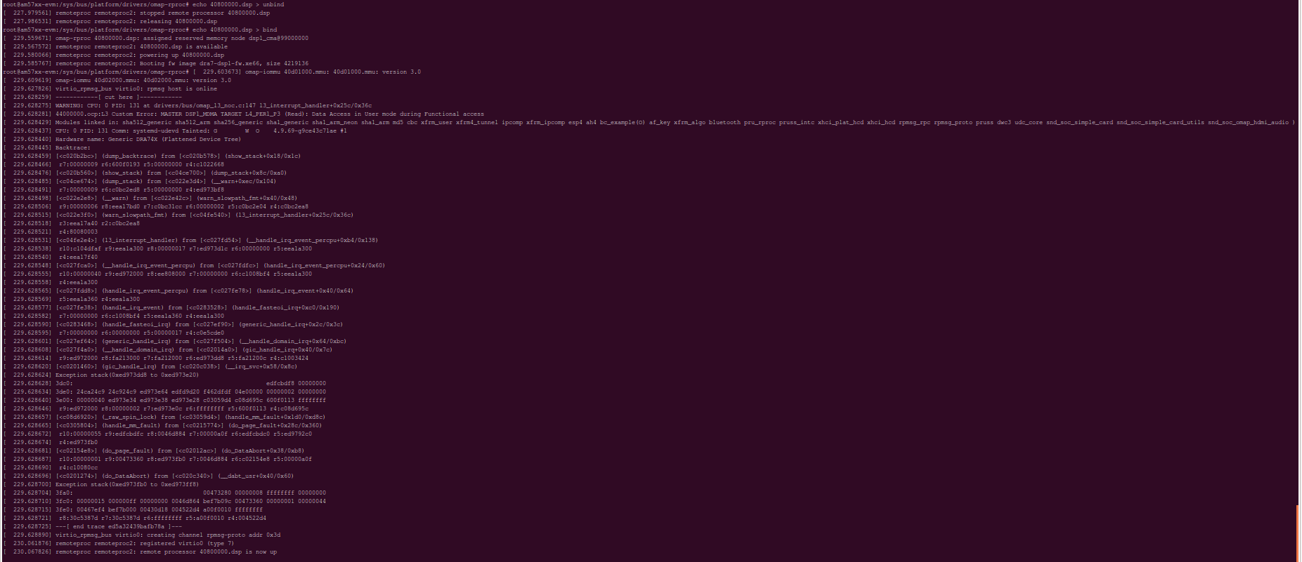

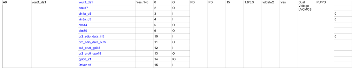

    Linux situation may cause GPIO2_27 not available on the DSP side?
    When I change GPIO2_27 to GPIO8_21, I get the following error message.
    GPIO8_21 PIN

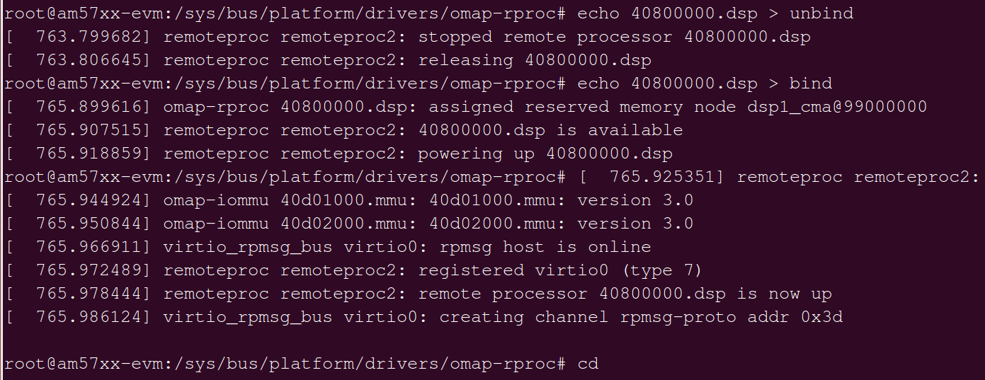

    When entering the following information, there is no error when loading firmware from the new one. What is going on?
    echo 245 > /sys/class/gpio/export
    echo out > /sys/clas/gpio/gpio245/direction
    cd /sys/bus/platform/drivers/omap-rproc
    echo 40800000.dsp > unbind
     echo 40800000.dsp > bind
    Why is this again?

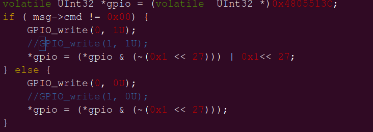

  • Hi
    Thank you very much for your reply, I have tried this situation.
    I looked at the GPIO2_GPIO_OE, GPIO2_GPIO_DATAOUT register values, GPIO2_GPIO_OE Register 27bit is 0.
    GPIO_write(0, 1U) is called at the DSP end. The value of GPIO2_GPIO_DATAOUT  27bit is always 0, which is equivalent to GPIO_write.
    When the DSP side writes 0 or 1 to the 27th bit of 0x4805_513C, it can control the high and low levels.
