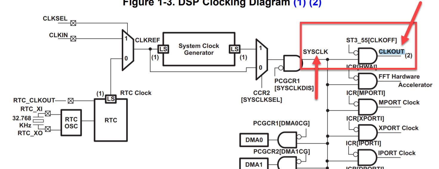

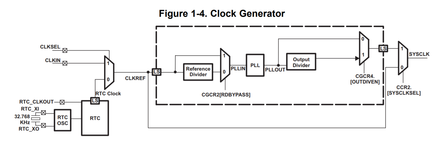

    There are two related parts. One is System Clock Generator and the other is ST3_55[CLKOFF] register to have control over CLKOUT pin. I attached some related images in order to show the relation between these two parts.
    In the image below, you can see the inner parts of the "System Clock Generator" unit.
    And the description:
    In the next two images below you can find how the  "System Clock Generator" is connected to CLKOUT and how its output driver could be disabled or enabled.
    For more information, you can take a look at this PDF  and see 1.4.2 Functional Description section.

  • Hi Kanchan,
    You can only observe the SYSCLK on the CLKOUT pin. It cannot be routed to a GPIO.
    If you adjust the SYSCLK to 5.4MHz, 27MHz, or 37MHz, then the whole system will operate with a SYSCLK at the same frequency. This might be too slow to perform processing within a specific time. Futhermore, any peripherals that derive their clocks from the SYSCLK will also run slower.
    And the CLKOUT pin is not intended to be used by any other device. It is available for debugging purposes, so you can probe the frequency of the SYSCLK. It is not guaranteed to be glitch-free.
    You can configure the SYSCLK and CLKOUT pin in a GEL file or in source code. To enable the CLKOUT pin, set the CLKOFF bit in the ST3 system registers. I recommend you use some other clock like an unused I2S CLK, which can derive its frequency from SYSCLK with an integer, power of 2 divider.
