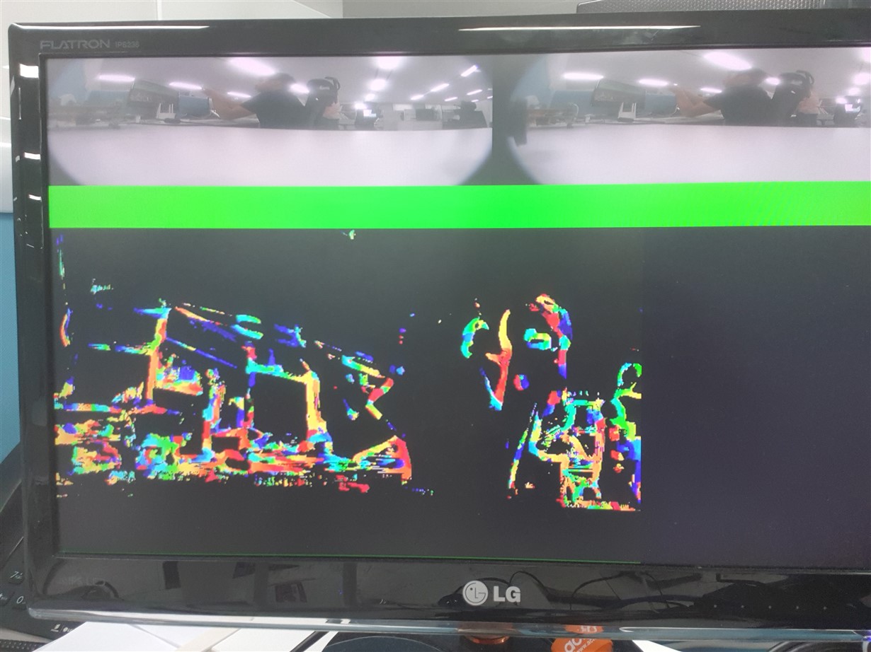

  • Hi Anuj,
    Could you try below usecase?
    NullSrc(A15) -> Dup_CensusIn(IPU) -> Alg_Census(EVE) -> Alg_DisparityHamDist(EVE) -> MergeStereo(IPU) -> Alg_StereoPostProcess(DSP) -> Display_Disparity(IPU)
    Dup_CensusIn(IPU) -> MergeStereo(IPU)
    The NullSrcLink is 2 channel and FHD input image each other.
    If I set 2 of the output channel number, it has error cause PPROC_LINK_MAX_NUM_INPUT_CHANNELS is defined by 2 in StereoPostProcess_Plugin.
    Heechang
    Your nullSrc has 2 channel and after that you are adding dup which goes to merge and Alg_Census.
    So the merge with output 1 queue with 4 channels, so Alg_StereoPostProcess will get a 4 channel input, which will cause issue.
    Alg_StereoPostProcess can take a 2 channel input so if you use 1 channel in nullSrc and have the same usecase then your merge link will output 2 channel which is the requirement for Alg_StereoPostProcess .
    Anuj
  • Hi Anuj,
    In usecase like below, it works well although 4 channels input into Alg_StereoPostProcess.
    The Merge_StereoOut comes 4 channels from Dup_CensusIn(2 channels) and Alg_Census(2 channels).
    IssCapture -> IssM2mIsp -> IssM2mResizer_Capture -> Select_Capture -> IssM2mSimcop -> Merge_Simcop -> Dup_Simcop
    Select_Capture -> Merge_Simcop
    Dup_Simcop -> Sync_Org -> Alg_DmaSwMs -> Display_Org
    Dup_Simcop -> Sync_CensusIn -> Dup_CensusIn -> Alg_Census (EVE1) -> Alg_DisparityHamDist (EVE1) -> Merge_StereoOut -> Alg_StereoPostProcess (DSP1) -> Display_Disparity
    Dup_CensusIn->Merge_StereoOut
    IssM2mIsp -> Alg_IssAewb
    GrpxSrc -> Display_Grp
    I'm checking the Disparity and Stereo algorithm.
    Like 2 channel camera input, I use 2 channel image input to Alg_census.
    But, if I use 1 channel in nullSrc I cannot check the Disparity and Stereo algorithm, right?
    Heechang
  • Hi Anuj,
    I modified the parameters in usecase.
    Dup : 1 queue(2 channels) output into EVE. (previously 2 queues output into EVE and merge stereo link)

    The Dup link should be 2 to 6 output queues?cannot be 1?
    Heechang
    I'd like to check the stereo disparity algorithm using nullSrc.
    In order to check this, nullSrc should be 2 channels cause of 2 channels input for census algorithm.
    I have right and left view images for nullSrc.
    Heechang
    We use Dup if we required to duplicate the output queue.
    So if you want to have only 1 output queue then there is no duplication.
    So in such cases (Dup having 1 output queue) dup link is not required, you can directly connect previous link of dup to next link of dup.
    Similarly merge is required only when you have multiple input queue and want to combine all inputs to a single out queue.
    If you have only 1 input queue then there is no requirement of merge link.
    About your usecase mentioed in previous post there is Select_Capture link which will provide outout to either IssM2mSimcop or Merge_simcop. So ideally Merge_Simcop is getting only 1 input queue. So The Merge_StereoOut comes 2 channels from Dup_CensusIn(1 channels) and Alg_Census(1 channels).

    I attached the photo which is the result of disparity map.
    But, the result looks like edge detection.
    Please, check this.

    Are you using any TI Usecase or you have created/modified any usecase?
    it also seems like the camera calibration is not done.
    Please check the below doc and complete all the process
    vision_sdk\docs\FeatureSpecificUserGuides\VisionSDK_UserGuide_TDA2xx_StereoCalibrationGuide.pdf
    Anuj
    I created the usecase in HLOS which is reference for "vision_sdk/apps/src/rtos/usecases/iss_mult_capture_isp_simcop_stereo_tda3xx/ ".
    The photo looks like detecting edge which you think that this problem looks like camera calibration?
    The camera team is not ready to build up camera calibration.
    So, I'd like to check the algorithm with 2 images input(right and left image I have).
    What usecase can be checked?
    You said that "NullSrc(A15) -> Alg_Census(EVE) -> Alg_DisparityHamDist(EVE) -> Alg_StereoPostProcess(DSP) -> Display_Disparity(IPU)" is impossible.

    Please add sync link after nullSrc and try.
    Anuj
    Yes, I added sync link and check the image.
    But, the result is same with still images.
    Heechang
    I have right and left still images and display it through stereo vision algorithm.
    The input image size is 1280x720 and also remap width and height set same size(1280 and 720).
    If I modify remap size, then the result image is broken.
    In case only input and remap size should be set by same vaule, the image is not broken but the result looks not stereo vision(looks same with attached photo in this post.).
    In your many stereo vision usecase, remap width and height is set by 800x384.
    If I set this size, the image is broken.
    How should I set the values in stereo vision?
    In vision sdk v3.4, your stereo vision is verified?
    Heechang
    That means the images are not proper.
    Please try to take images from the properly calibrated cameras.
    Anuj

    I resolved this issue.
    But I don't understand.
    In postprocessing and census algorithm, the left and right channel is mapped ch[0] and ch[1].
    But if I input left image to ch[1] and right image to ch[2], the result is good.
    Anyway, I resolved this issue in HLOS.
    Heechang
