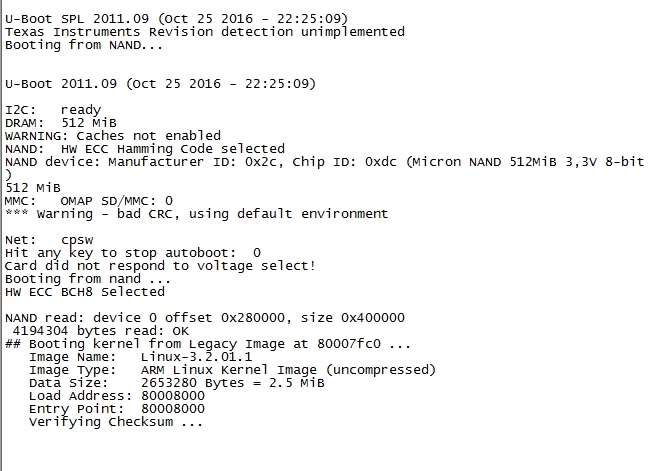

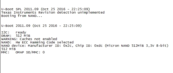

We have some MBs which have NAND booting failed issue. And it hangs in u-boot stage after using for a while
below log is failed message
below is ok message

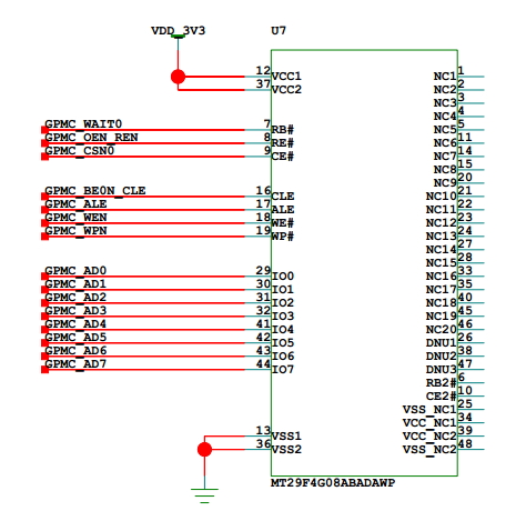

below is the nand flash schematic
Does TI have any suggestion or we miss something for this case?
