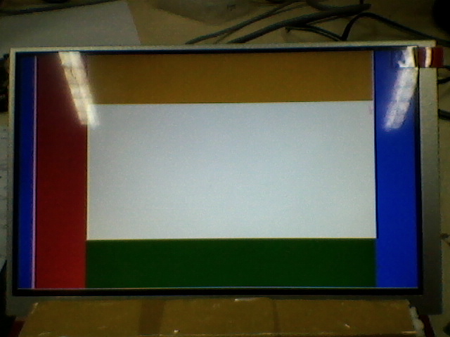

But I guess I am getting weird image on LCD..I have pasted both the images below.

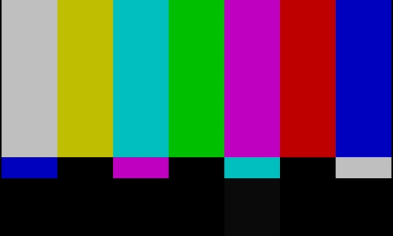

This is the original Image...
But I am getting this on LCD...
Any guess , why this is hapenning ?

  • Hello All,
    finally I have been able to get full size image on display.
    Actually the problem was I was trying to display image with different pixel depth than specified using fbset.

  • Folks ,
    It was just a connection problem with my conector now its fine.
    Its displaying nice colors.
    But now I have one another problem.
    As you can see I want to this image,
    and I am getting this...
    have you noticed the blue vertical strip on left hand side ?
    I have tried setting left/right margins and HSYNC_length but the shifting and rolling over is always present...
    can anybody suggest me what to do ?
  • Oops silly mistake agian..
    I  was not removing BMP header ;)
    after removing first 54 bytes its absolutely perfect now !!
    thank you all for reading this ;)
