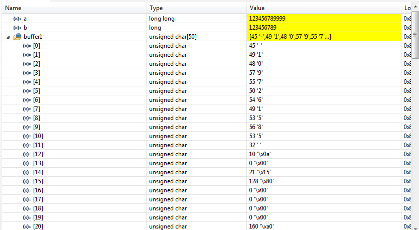

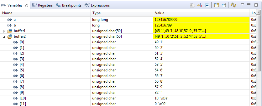

  • Hello Eric,
    It didn't work for me,
    I have tried the following code, but i get an incorrect values for long long:
      char buffer1 [50];
      char buffer2 [50];
      long long a = 123456789999ll;
      long b = 123456789l;
      unsigned int n1, n2;
      n1=sprintf (buffer1, "%ld \n", a);
      n2=sprintf (buffer2, "%d \n", b);
    sprintf - long long:
    sprintf long:
    please advise,
    Sergei Pilipenko
