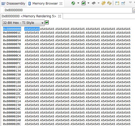

After connecting, executing the following resulted in an error.
Scripts -> AMIC110 DDR Tests -> DDR_DataTransferCheck
When looking at the value of 0x80000000 in the memory browser, erroneous values were written.
This value changes randomly.
Next, I connected TMDXICE110 with CCS using the following Gel file.
C:\ti\ccsv8\ccs_base\emulation\boards\evmam3358\gel\AM335x_15x15_EVM.gel
The connection succeeded when we did the following.
Scripts -> AM335x DDR Tests -> DDR_DataTransferCheck
Why does DDR3 not work properly when using Gel for TMDXICE110?
Is this a gel file malfunction?
