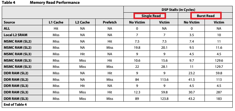

        I'm reading the doc "Throughput Performance Guide for C66x KeyStone Devices",and find the table as following.
        So I'm curious about what the different between Single Read and Burst Read? Thank you.
  • In general a burst is referring to any situation in which a device is transmitting data repeatedly without going through all the steps required to transmit each piece of data in a separate transaction.
    For example with the memory, burst is when you send one address to the memory, but rather than reading/write the data only for the specified address, you also read/write some number of consecutive locations(typically 4 or 8).
    While for single read, you read only one memory address (region).
    Yordan
  • Hi Yordan
    I think what you say means that, if I read a series of continus data, it is single read, because I don't need to read the address(it just increment). If I read some data ,each in a rand address, it is burst read.Is it right?
    Yuchao
    Let me try to explain it simpler.
    Suppose a single write is the following:
    You give a start address and read 4 bytes of data for a given amount of clock cycles
    A burst write is:
    You give a start address and read 16 bytes of data for the same amount of clock cycles.
    Same with reads.
    Yordan
