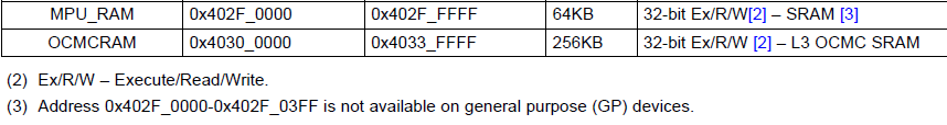

According to TRM, on GP device, on-chip RAM start from 0x4030_0000, why the entry point is 0x402f_0000? I tried on my AM437x IDK board REV1.3A, address of 0x402F_0000 can't be accessed.  Is it always available for ROM bootloader not for user?
    Yes, that is correct. This explained in the ROM L3 RAM Usage map that is shown in the TRM as shown below. this reqion in the ROM is reserved for secure and core startup services. If you see the startup code that runs on the core that sets up interrupt vector table and cache, mmu is placed there. The main SBL function is usually not locate in that region.

  • From the TRM:
    5.2.3.2.1 Downloaded Image (ISW)
    This area is used by the Public ROM Code to store the downloaded Initial SW. The downloaded image
    can be up to 271KB on GP Device. It resides from 0x402F4000 (0x402F0400 for PG1.1) to 0x40337C00
    in GP device.
    Note: If ROM boots using USB_MS boot mode, then the image can reside only from 0x40300000. This
    limits the maximum image size while using USB_MS boot mode to 220KB.
  • Sorry, just noticed you were asking about QSPI specifically. The 0x402F4000 address is common for boot modes like MMC where the image gets copied by the ROM into internal RAM. Looks like Rahul answered at nearly the same time as me, but with a better answer! :-)
