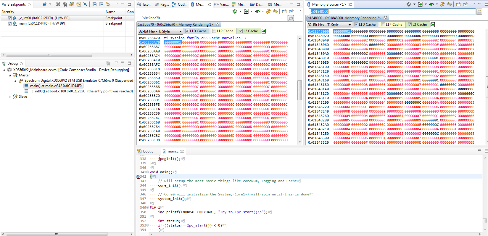

Abstract of the Problem:
We are updating all libs of our c6678-Project to newer versions which are coming with the the "sdk-rtos-c667x-evm-04.03.00.05". In the current
state the MAR-CPU-Registers are corrupted when reaching the "main" after "_c_int00". Depending on the values, some Core's won't see the
MAGIC_ADDRESS, because thier addressspace became unwanted cacheable in Core_0. The DSP is booting from a SPI-Flash.
Version/Build details:
Custom-Board. Our Project is compiled with the 8.1.3 Compiler in CCS 8.1.0.00011.
Probably most relevant version changes related to this Problem:
Old:
      XDCtools:             3.25.4.88
      SYS/BIOS:             6.35.4.50
      (PDK 6678:            1.1.2.6)
New:
      XDCtools:             3.50.03.33
      SYS/BIOS:             6.52.00.12
      (PDK 6678:            1.1.2.6)
PDK isn't changed to the PDK C667x 2.0.9 because we can't currently build with this version in the moment.
Question0: Is a change neccessary?
The error occurs with BIOS config "instrumented" and "debug". The project is compiled in both cases without optimization.
The constants for MAR's are placed in *.map:
.const.3   0    0c2aef80    00011d44     UNINITIALIZED
"other stuff"
0c2bba70    00000400     firmware_pe66.oe66 (.const:ti_sysbios_family_c66_Cache_marvalues__C)
"more other stuff"
Sidenote0: const.3 is placed in MSMC-Ram
Sidenote1: When looking into firmware_pe66.c we can see the correct default values for the token "ti_sysbios_family_c66_Cache_marvalues__C"
Question1: What is the exact meaning of "UNINITIALIZED"?
The MAR's Hardware addresses are beginning at: 0x01848000 (MAR0-MAR255)
What happens with screens:
The first screen shows the state of the addresses when we reached the "_c_int00" routine. The constants are not loaded. The MAR's have default values.
This is funny because they have exactly the same values what should be written anyway, when the constants are loaded.
The second screen shows the state of the addresses when we reached the "main" function. The constants are loaded. The MAR's are broken, because the last
nibble comes from the uninitialized constants. With the Debugger we could track that the MAR's are indeed initialized with the uninitialized constant
values. So the constants must be loaded sometime later.
With the old libraries we obviously didn't had this problem.
Question2: Are the constants loaded too late or the initialization of the MAR's is too early?
Question3: When should the constants be loaded?
Question4: Who is responsible for loading the constants?
Sidenote: Reseting the CPU/System and loading the *.out into the Core0 didn't change anything.
Sidenote: When the constants are loaded (second screen state), then resetting the system causes all the Cores to start correctly.
If more informations are necessary, please ask.

  • Sorry for the delay. Can you please provide a small sample project with the behavior you are describing?
  • The stripped project is attached to this replay, the password will arrive through pm.
    The "jpeg.c" file is important for reproduction of this error. Use the "#define NO_ERROR" for switching between correct and misbehaviour.
    After building, the "DSP_Firmware.out" and "DSP_Firmware.map" can both be found under "DSP_Firmware/Release/".
    One particular interesting thing i found is, that with the JPEG stuff the "ti_sysbios_family_c66_Cache_marvalues__C" are placed in ".const.2"
    section, but the ".const.2" section is "UNINITIALIZED". When "NO_ERROR" is 1, then "ti_sysbios_family_c66_Cache_marvalues__C" are placed in
    ".const" section, but without the "UNINITIALIZED" keyword.

    I can give you in the meantime additional infos:
    It looks like the JPEG-Encoder is only the trigger for the misbeaviour. When the encoder is not used, then the ".const" section is not loaded through the ".cinit" section, so its loaded at "boot time"? With the encoder the ".const" section will be loaded at "run time" and then, the misbevaoiur occurs, because it seems like it happens too late and looks like a bug.
    I can work around this problem, when i change the Linker option "Initialization model" from "ROM" to "RAM" so that every initialization happens at "boot time".
    Kind regards,
    Lukasz

    Kind regards,
    Lukasz
  • Lukasz, unfortunately, after checking internally we are not supporting C66x codecs directly but via 3rd parties. I will send you our 3rd parties information in a private message, so you can contact them.
    I believe the solution would be to rebuild JPEG encoder library with latest tools. And taking care .cons is located in the correct memory section so it gets initialized correctly.
    Another idea could be try to force .cons to be located in another section, via CCS View/Edit platforms in RTSC tools.
    A related thread for your information:
    Or you can add  a modified linker in CCS *.cfg. via "Program.linkTemplate". I documented a high level steps/tips in this app note sections 4.2.1 and 4.2.2. In that app note, we moved some critical sections to a closer memory using an linker *.xdt file
    thank you,
    Paula
  • Hi Paula,
    thanks for the infos/ideas. I need to discuss the further steps with the team leader, since changing the "Initialization model" from "ROM" to "RAM" also works fine.
    Thanks for the help and kind regards,
    Lukasz
