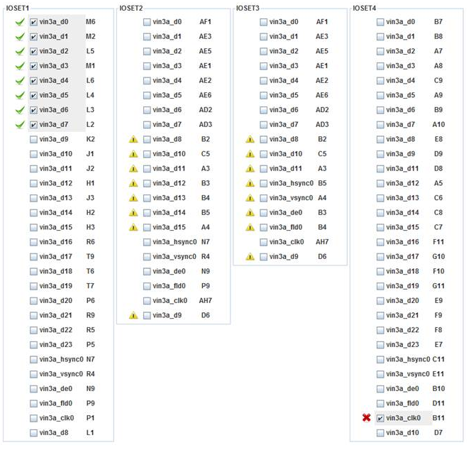

We will use Vin3a pin and vout1 pin like below.
- Will use  Display output Pin with discrete sync mode - vout1_clk (ball : D11), vout1_d0(ball : F11)...... vout1_d22(ball : B9). vout1_d23(ball : A10), vout1_de(ball : B10), vout1_hsync(ball : C11), out1_vsync(ball : E11),
- We want to use vout1_fld as  Vin3a_clk0 of VIN3A. -  VIN3A Input : Vin3a_clk0 (ball : B11),vout3_d0(ball : M6), vout3_d1(ball : M2)....
Can I use the vout1_fld pin as the Vin3a_clk0 pin of VIN3A while using the display output pin(vout1) with discrete sync mode?
