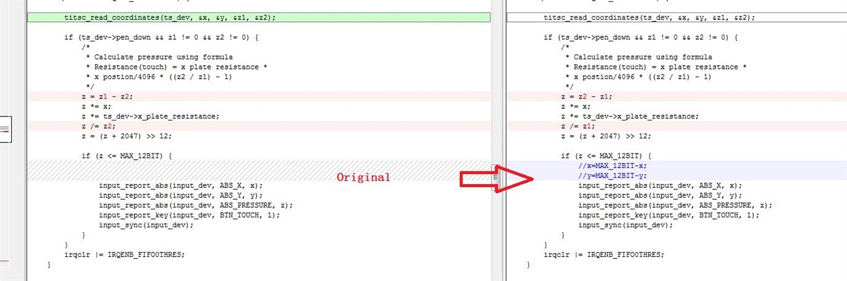

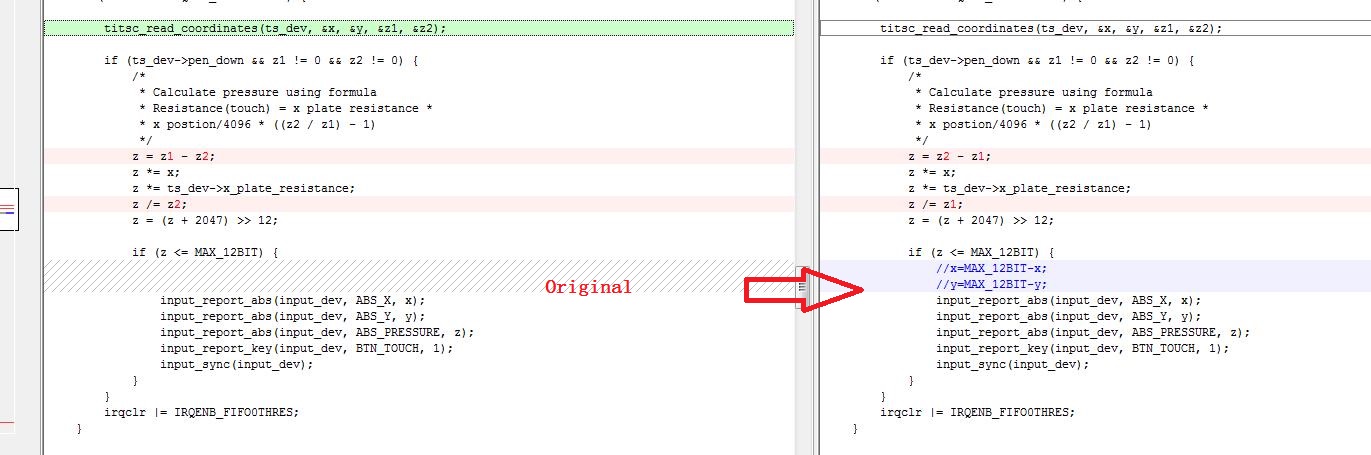

in code: drivers\input\touchscreen\ti_am335x_tsc.c, Pressure formula code is not correct to comments, single point touch is right with both original and modified code, but for multiple point touch, with the modified code is more precise than original code, please help to double confirm.
                     * Calculate pressure using formula
                     * Resistance(touch) = x plate resistance *
                     * x postion/4096 * ((z2 / z1) - 1)

  • Hello Tony,
    Based on the naming convention I would expect the customer to be correct. However, it looks like the code is doing some sort of normalization by adding 2047 before dividing by 4096, so the programmer might have swapped Z1 and Z2 on purpose. I am not clear on why it was programmed the way it was.
    The software owner is on vacation until next week, so if I have not responded by next week please ping me a reminder. If the customer wants to run experiments in the meantime by inserting printk statements into the driver, we have kernel debug resources here.
    Nick

  • Hello Tony,
    Z1 and Z2 were swapped in this commit - before then, the code and the comment were aligned. There was no explanation as to why Z1 and Z2 were swapped, so the software owner is spending some time analyzing the patch now.
    Nick
  • Hello Tony,
    The IP owner cannot find anything that supports swapping Z1 and Z2, so we are operating under the assumption that the change was a mistake.
    Could the customer provide logs of the pressure reported with z = (z2 - z1) and z = (z1 - z2) and highlight what actually goes wrong? That will help us justify changing it back and submitting a fix to the upstream kernel.
