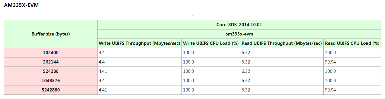

  • Thanks for your reply, and about NAND Driver test, what command or script should I use to get a test conclusion similar to the following figure?

    Sorry for the delay. We use an application in our test suite to gather this data for NAND performance. You can take a look at the code here:
    arago-project.org/.../
