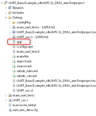

  • the app file is the final application that you need to run from flash. In this case since you are using GPIO LED example to test the booting the app file in the GPIO LLD example is the flash image you need:
    boot : Rename the MLO file from pdk_am57xx_1_0_11\packages\ti\boot\sbl\binary\idkAM572x\qspi\bin  to "boot"
    app:  This is the final application that you want to run from flash. In your case, this is app generated in the GPIO LLD example in the Debug folder.
    config: This is the file from pdk_am57xx_1_0_11\packages\ti\boot\sbl\tools\flashWriter\qspi.  No need to modify default.
    I am showing the screenshot of the app from PDK UART Examples for reference so you know where to locate it with your setup:
    Hope this resolves your issue.
    Rahul
