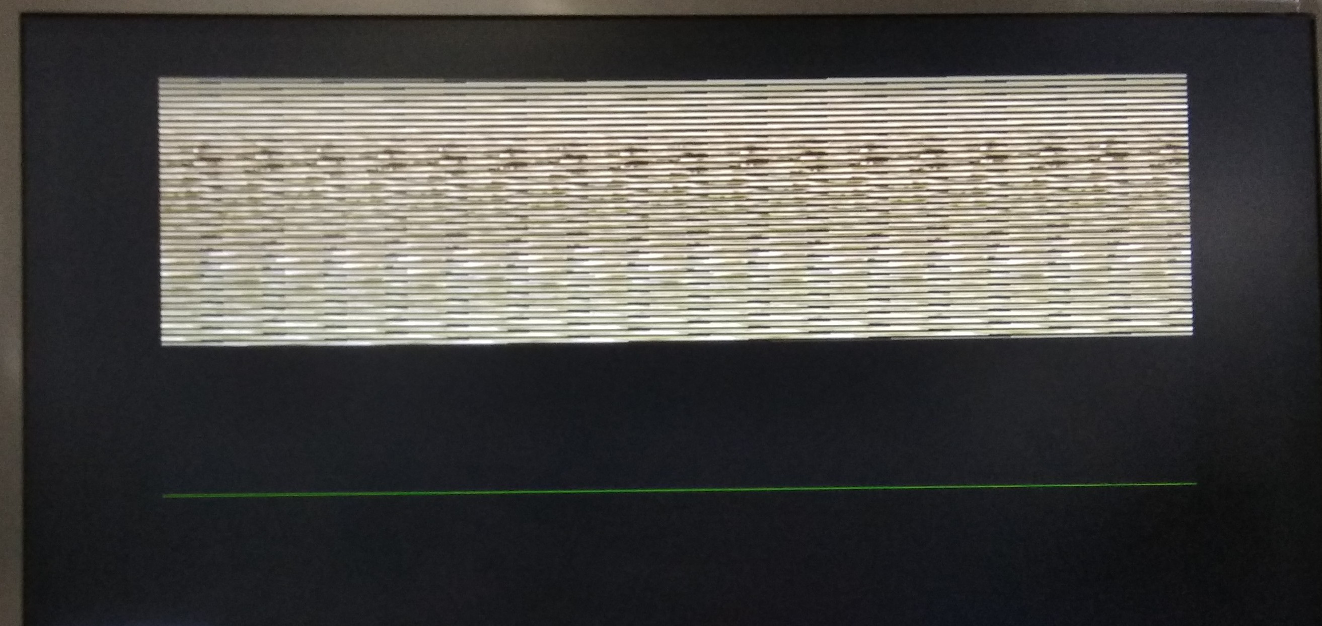

    Beside this I tried one approach like, I changed the usecase as below:
    UseCase: chains_capture_tidl_OD
    Capture ->Alg_ImagePreProcess(EVE1) -> VPE -> Dup
    Dup -> Merge
    Dup -> Alg_tidlpreproc (A15)
    Alg_tidlpreproc (A15) -> Alg_tidl_Eve2 (EVE2)
    Alg_tidlpreproc (A15) -> Alg_tidl_Eve3 (EVE3)
    Alg_tidlpreproc (A15) -> Alg_tidl_Eve4 (EVE4)
    Alg_tidl_Eve2 (EVE2) -> Merge_OD (DSP1)
    Alg_tidl_Eve3 (EVE3) -> Merge_OD (DSP1)
    Alg_tidl_Eve4 (EVE4) -> Merge_OD (DSP1)
    Merge_OD (DSP1) -> Alg_tidl_Dsp (DSP1) -> Merge
    Merge -> Sync -> Alg_ObjectDraw -> Display_Video
    GrpxSrc -> Display
    Removed the Alg_tidl_Eve1 (EVE1) and changed the .c file accordingly.
    It's running without error, but showing output like this:
    Is this approach is right? Please guide me to resolve this.

    TIDL_OD is not tested using capture link.
    Its been tested on file read.
    You need to train your model for the input.
    Anuj
  • Hello Anuj,
    I have modified tidl_OD use case for taking input from HDMI and it's working, but when I have added Alg_ImagePreProcess link after capture it's displaying output like previously attached image.
    Sayali V.
    Why you want to use Alg_ImagePreProcess link.
    The kink is used when you want use ti developed object detection algorithm not with TIDL.
    Anuj
  • Hello Anuj,
    I want to try and observe effect of pre processing on TIDL inference. I think pre processing may improve the detection results that's why I need to try that.
    Sayali V.
    The issue is coming due to format of Alg_ImagePreProcess and tidl is not matching.
    And the both of the link has been tesed in a single usecase flow as both of them are used with 2 separate algos.
    Still if you want to check you can coneect with CCS and debug where the format is going wrong.
    Anuj
