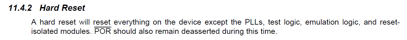

3) In datasheet §11.4.2 we can read
which finaly reveals to be true ONLY if the PLL controler RSISO initialization has been programmed accordingly. If not, PLL is reset to default and must be reprogrammed (see §5.1.3 of the hardware design guide)
    In case of misalignment between user guide and the datasheet, the recommendation is to always refer to the Datasheet, as it is the most frequently updated document.
