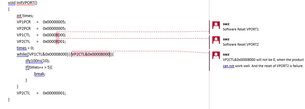

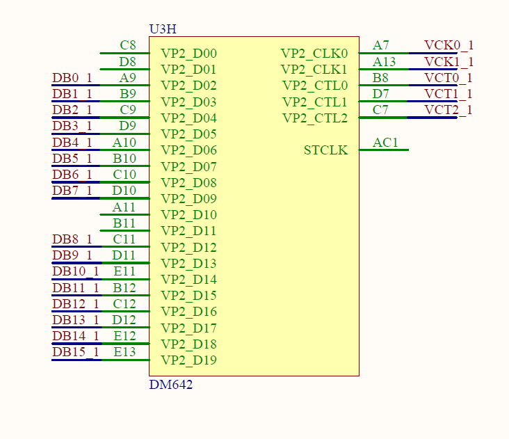

VPORT2 is reset failure.
The schematic as below picture(DB0_1-DB15_1、VCK0_1-VCK1_1、VCT0_1-VCT2_1 Connect with FPGA):
The code and issue as below picture:
