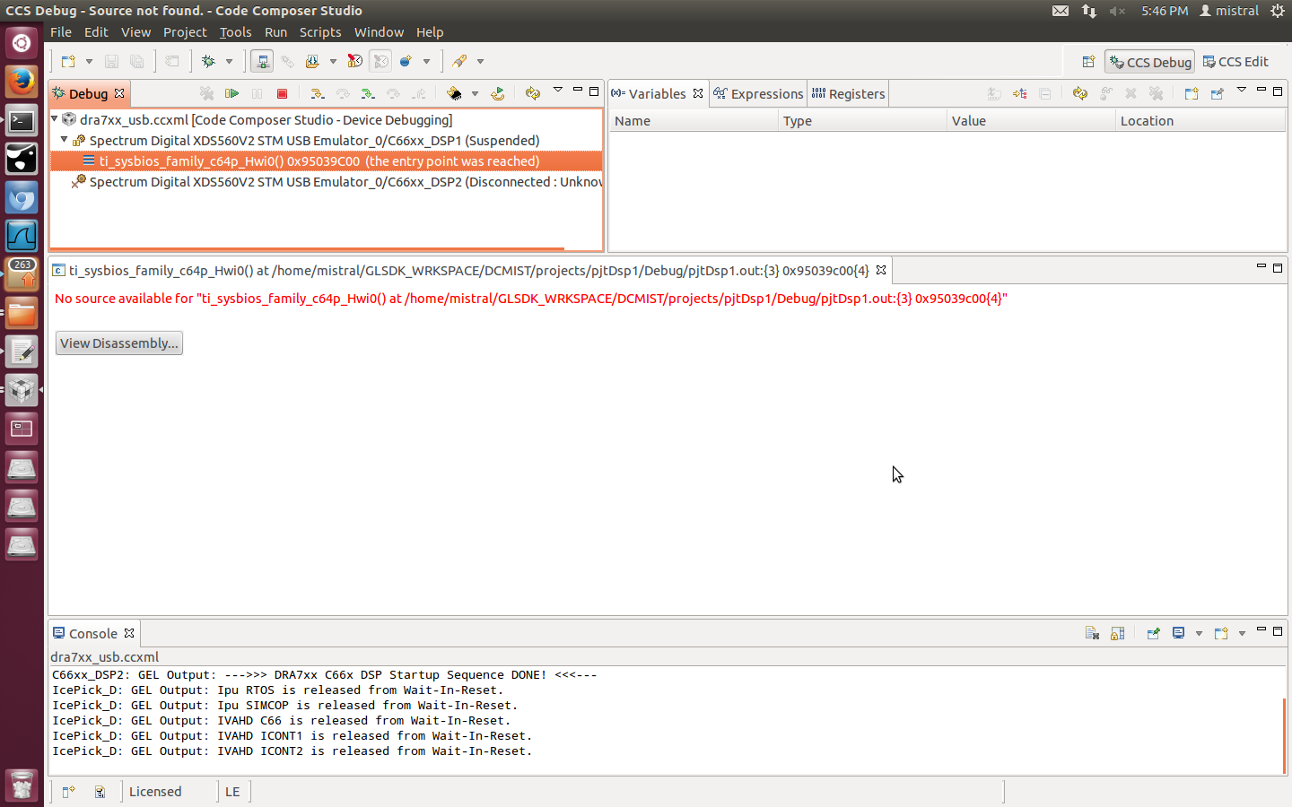

i am trying to debug running dsp the EVM code through ccs.
I  am using glsdk-6.10 sdk and CCS5
I am debugging through Run --> Load -->load symbols.
The DSP firmware is compiled with full debug option enabled.
when i trying to load the symbols i am getting error like "no source found "ti_sysbios_family_c64p_hwi_int0"
and after that its not hitting the break point also.
Let me know how to proceed further.

  • Biswajit,
    Can you also send a snap shot of what you are seeing in the CCS window?
    Thanks and Regards,
    Piyali

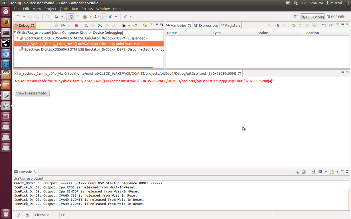

  •  Hi Piyali,
    Please find the attached screenshot of the log message.
    Biswajit
  • Biswajit,
    Thanks for sharing the screenshot!
    This message common if you have not pointed to the source of the code. Typically there is a "Locate File" Button which shows up below/above "View disassembly". Can you try hovering around the "View Disassembly" button and check if the "Locate File" shows up. Once the locate file shows you can then choose the path to the file and then proceed debugging...

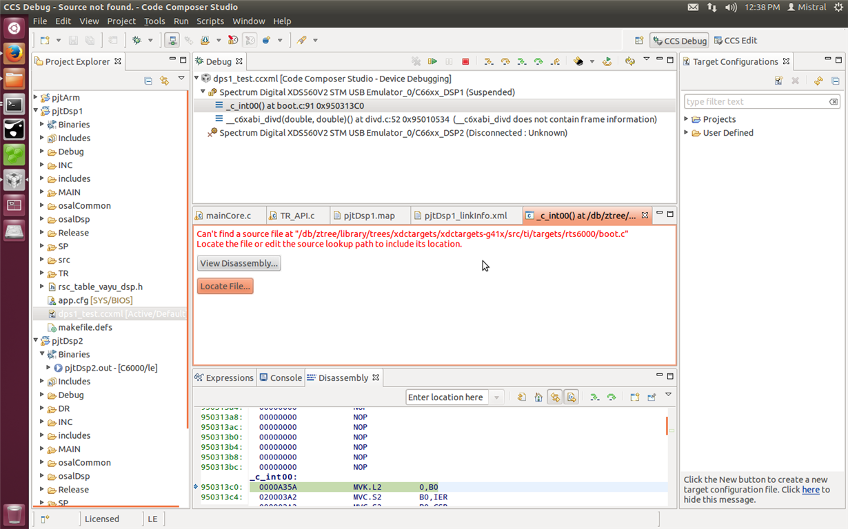

  •   Hi Piyali,
    I have built the DSP1 image in Debug mode only.
    Its looking for boot.c in /db/ztree/library/trees/xdctargets/xdctargets-g41x/src/ti/targets/rts6000/boot.c.
    But /db/ztree folder itself is not available in my system and  i have not configured also.I dont have idea from where its fetching the path.
    I have attached the screen shot of the same.
    So i have provided packages/ti/targets/rts6000 folder path when it asked to locate file.
    Then when i continued the assembly single step into then it got stuck with the error:
    "Can't find a source file at "/tmp/TI_MKLIBr78rCW/SRC/copy_decompress_rle.c"
    Locate the file or edit the source lookup path to include its location."
    But neither copy_decompress_rle.c nor /tmp/TI_MKLIBr78rCW folder available in my system.
    Now i am not having any clue from where its searching these path.
    Please let me know if have any solution for the same.
    Biswajit
  • Biswajit,
    The path shown in the CCS is what it picks up from the pre-built library. BTW, looks like the boot.c file is from BIOS package: bios_XX_XX_XX_XX\packages\ti\targets\rts6000\boot.c
