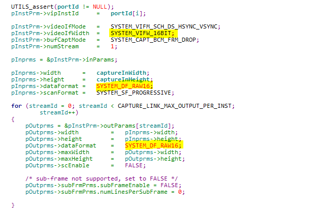

  • Hi Sujith,
    I updated to 16bit raw as following,
    But I still faced following error. Any idea? What do you think?

  • Hi Chee Peng,
    From the log, it seems like capture creation is completed successfully. It's the SWMS link which is creating a problem.
    The SWMS will not support RAW 12 data format. You would require s/w module to convert RAW12 to YUV data format.

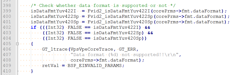

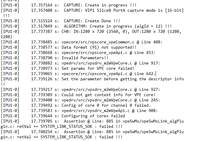

    Anyway, I adjusted at vpeSwMs/vpeSwMsLink_algPlugin.c
    It gave more error as following
    I tried traced it, the error deep at Ti component.....
    What do you think?
  • Hi Chee Peng,
    It seems like the data type is not overridden. As the very first error that you are seeing is being reported by VPE for wrong data-type.
    Can you please debug on this front?

  • Dear Sujith,
    Seems we stuck here, based on the TDA2x, there is "NO ISP on chip" so Can we say it is not possible for TDA2X to support camera module without ISP? Or otherwise we need to implement a software ISP on chip for it to work?
    Thanks and best regards
    He Wei
  • Hi He Wei,
    Yes, you are right. TDA2Px/TDA3x comes in with built in ISP. Please check if these devices can meet your needs.
