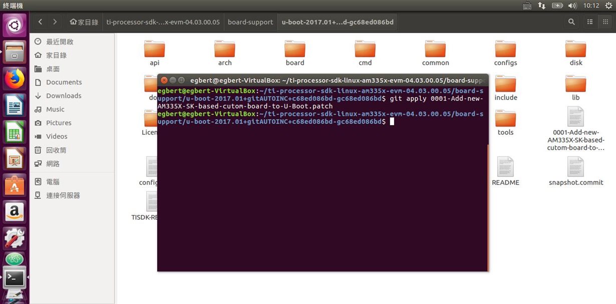

  • Hello Egbert,
    Please, apply this patch.
    cd <Processor SDK>/board-support/u-boot-<version>/
    git apply 0001-Add-new-AM335X-SK-based-custom-board-to-U-Boot.patch

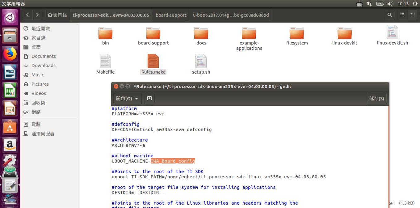

    Change the U-Boot machine name from UBOOT_MACHINE=am335x_evm_config to UBOOT_MACHINE=IWA_Board_config in <Processor SDK>Rules.make and type make u-boot_clean && make u-boot from the top Processor SDK directory to rebuild the U-Boot.
    Put the SD card to your host machine, copy the new images (MLO, u-boot.img) to boot partition and am335x-evmsk.dtb as IWA_board.dtb to rootfs with the following command.
    sudo cp /media/<username>/rootfs/boot/am335x-evmsk.dtb /media/<username>/rootfs/boot/IWA_board.dtb
    Kemal

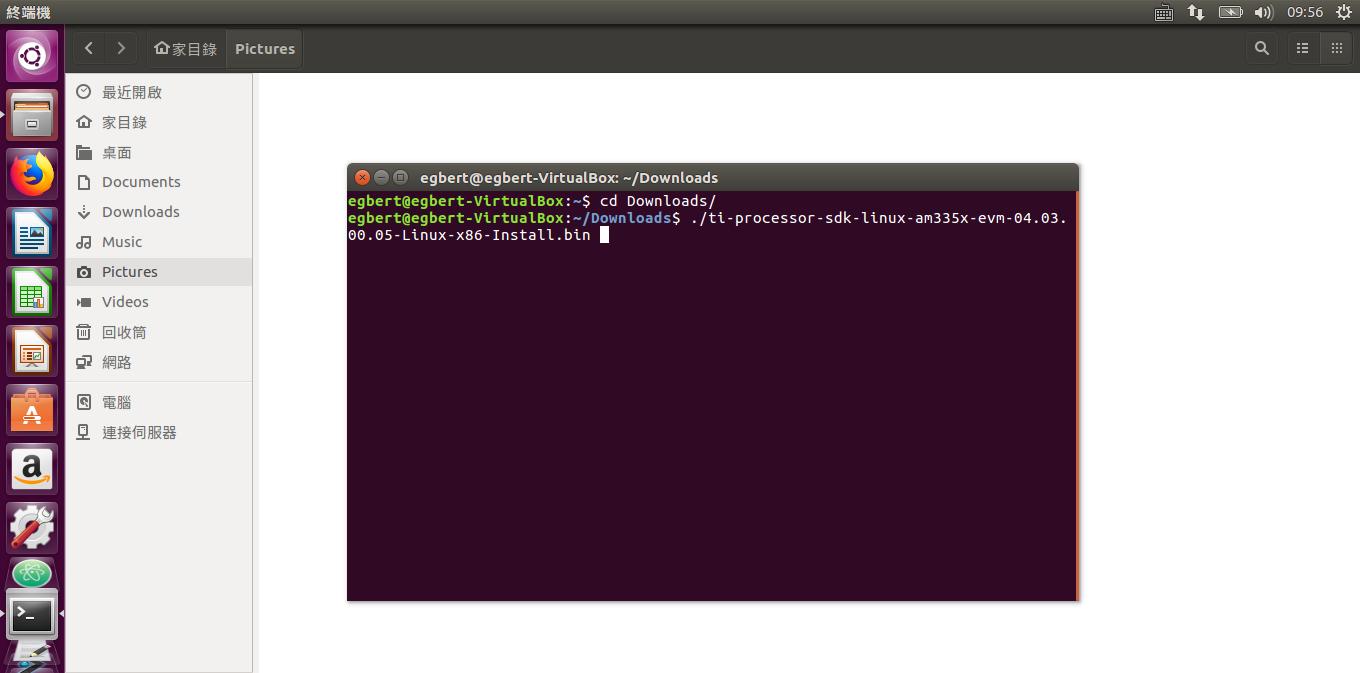

    < Step1>   unzip and install Pur-SDK code to home/Egbert folder :

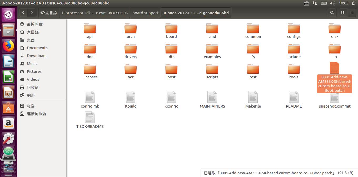

    < Step2>   Copy patch file to u-boot-xxxxxx under blow

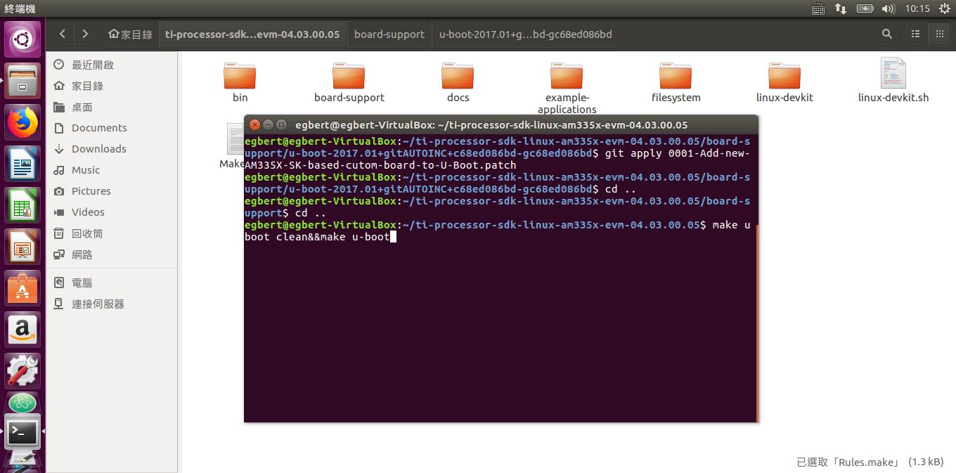

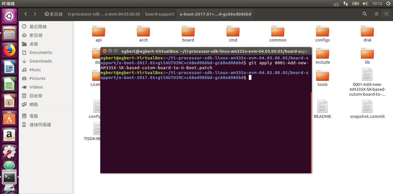

    < Step3>   Process the command :  git apply 0001-Add-new-AM335X-SK-based-custom-board-to-U-Boot.patch
    < Step4 >   Change the U-Boot machine name from UBOOT_MACHINE=am335x_evm_config to UBOOT_MACHINE=IWA_Board_config in <Processor SDK>Rules.make

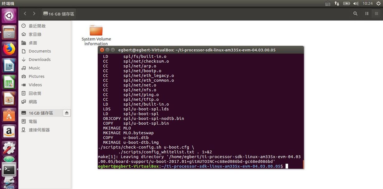

    < Step5 >  Type make u-boot_clean && make u-boot from the top Processor SDK directory to rebuild the U-Boot.
    < Step6 >   Rebuild PASS   and  put the SD card to your host machine, copy the new images (MLO, u-boot.img) to boot partition

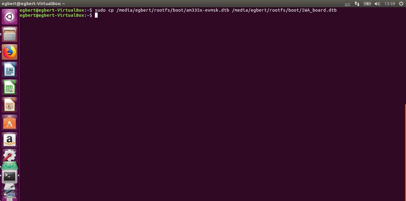

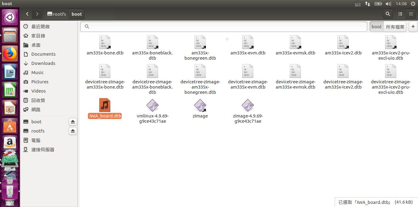

     < Step7 > am335x-evmsk.dtb as IWA_board.dtb to rootfs with the following command.
     < Step8 >  Check the IWA_board.dtb file in SD/rootfs/boot  undder below

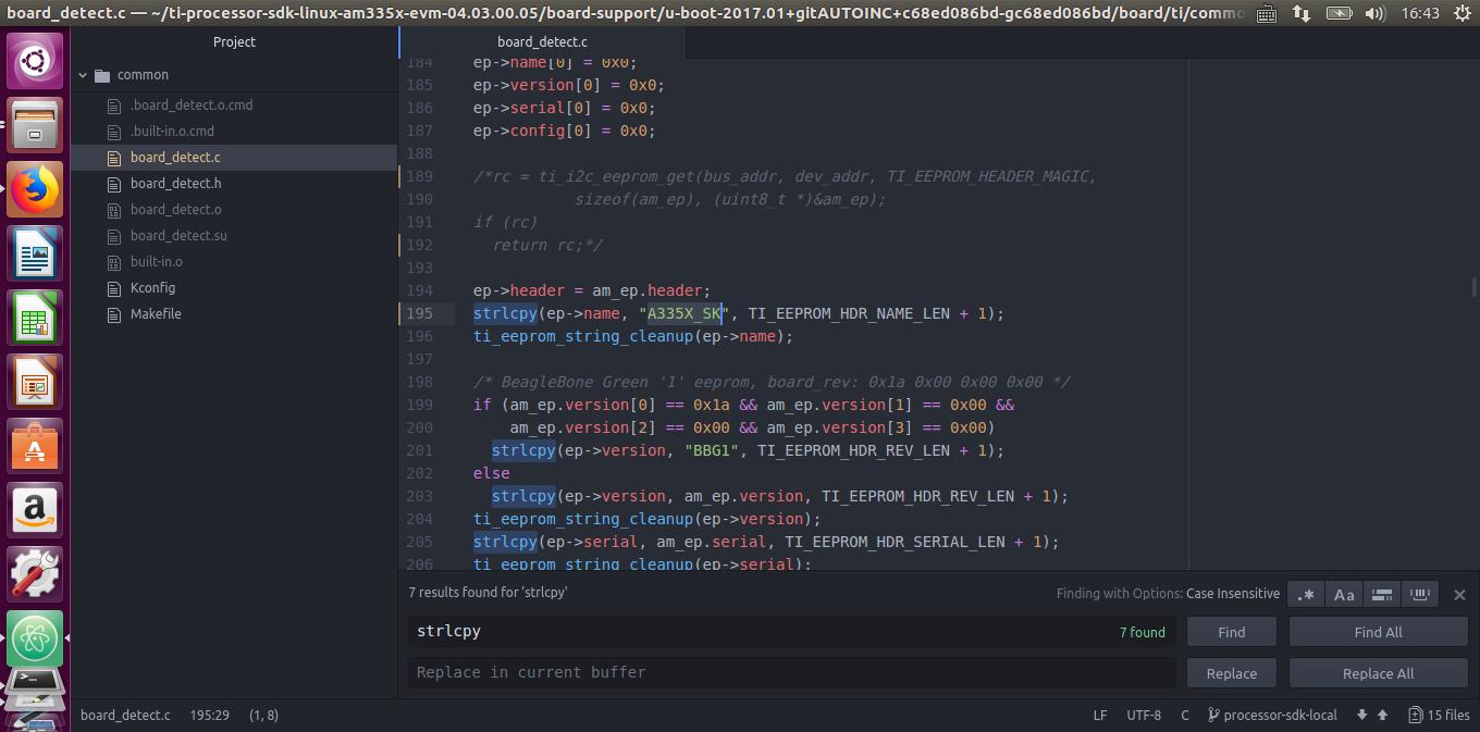

  • I've already done this and harcoded your board with AM335x Starter Kit's settings here.
    diff --git a/board/ti/common/board_detect.c b/board/ti/common/board_detect.c
    index 64149581c5..7ac4191624 100644
    --- a/board/ti/common/board_detect.c
    +++ b/board/ti/common/board_detect.c
    @@ -169,7 +169,7 @@ already_set:
     int __maybe_unused ti_i2c_eeprom_am_get(int bus_addr, int dev_addr)
    -    int rc;
    +    //int rc;
         struct ti_am_eeprom am_ep;
         struct ti_common_eeprom *ep;
    @@ -186,13 +186,13 @@ int __maybe_unused ti_i2c_eeprom_am_get(int bus_addr, int dev_addr)
         ep->serial[0] = 0x0;
         ep->config[0] = 0x0;
    -    rc = ti_i2c_eeprom_get(bus_addr, dev_addr, TI_EEPROM_HEADER_MAGIC,
    +    /*rc = ti_i2c_eeprom_get(bus_addr, dev_addr, TI_EEPROM_HEADER_MAGIC,
                        sizeof(am_ep), (uint8_t *)&am_ep);
         if (rc)
    -        return rc;
    +        return rc;*/
         ep->header = am_ep.header;
    -    strlcpy(ep->name, am_ep.name, TI_EEPROM_HDR_NAME_LEN + 1);
    +    strlcpy(ep->name, "IWA_BOARD", TI_EEPROM_HDR_NAME_LEN + 1);
         ti_eeprom_string_cleanup(ep->name);
         /* BeagleBone Green '1' eeprom, board_rev: 0x1a 0x00 0x00 0x00 */

  • Can you change the strlcpy(ep->name, "IWA_BOARD", TI_EEPROM_HDR_NAME_LEN + 1); line to strlcpy(ep->name, "A335X_SK", TI_EEPROM_HDR_NAME_LEN + 1); in <Processor SDK>/board-support/u-boot-<version>/board/ti/common/board_detect.c, rebuild, reflash (copy the MLO and u-boot.img to SD card's boot partition) and see if the board boots?
  • Hi Kemal,
    I modify this  A335X_SK string of Board.c and rebuild u-boot and put MLO, image to SD card.
    But Still, Boot on fail.

  • Egbert Liu said:
    [    0.000000] OF: fdt:Machine model: TI AM335x EVM-SK
    Comes from <Processor SDK>/board-support/linux-<version>/arch/arm/boot/dts/am335x-evmsk.dts:model = "TI AM335x EVM-SK";.
    Change the model name model = "IWA BOARD"; then execute make linux-dtbs, then cp <Processor SDK>/board-support/linux-<version>/arch/arm/boot/dts/am335x-evmsk.dtb <Processor SDK>/board-support/linux-<version>/arch/arm/boot/dts/IWA_board.dtb
    Put the SD card to your host machine, copy the new IWA_board.dtb to rootfs with the following command.
    sudo cp <Processor SDK>/board-support/linux-<version>/arch/arm/boot/dts/IWA_board.dtb /media/<username>/rootfs/boot/
    The rest of the "am335x-evm" string comes from /etc/hostname, the Arago project logo on tty login comes from /etc/issue and during net login from /etc/issue.net
