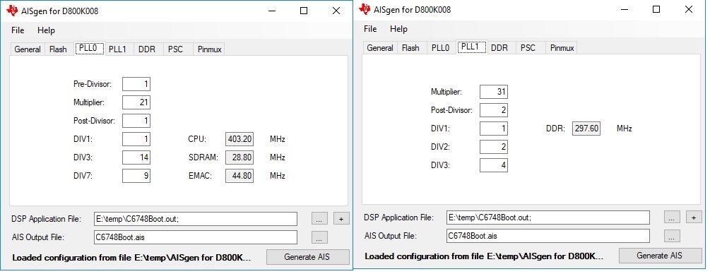

I have a custom board that I am attempting to do an AIS Nand Boot with the RBL, and it's failing to run.
  • CCS v 7.0.3
  • Compiler Version: 7.4.23 (legacy COFF output format)
  • AISgen for D800K008 Bootloader Version 1.9
I programmed in my AIS Image, RESET the chip and hi RUN in CCS (7.0.3).
When I pause the execution with my emulator, the chip is still stuck in the RBL memory space (around PC=0x007138D8).
My PLL setting look correct, and some of my PSC registers look correct, however my pinmux don't appear to be configured yet.  My flash EMIFA CE2CFG looks correct.
I used the OMAPL1x_debug.gel file to get the results below (and I looked at the registers view in CCS).
NOTE:  Since the GEL script did not support floating point numbers and my clock reference is 19.2 MHz, I changed the clock value in the script to 192.  That means all PLL clock values are in 10ths of Hz when they are displayed.  IE when the script says PLL0_SYSCLK1 is 4032 it actually is 403.2 MHz.   I'm not trying to clock the part with a 192 MHz signal :-)

When the bootloader is "hung up" i'm able to go to the Memory Browser and grab the AIS image form Flash (saved to a .dat file).  I verified the entire image is in Flash, all the sections are accounted for, and the final "Jump and Close" command (0x58535906) reflects the proper _c_init00 address.
The L2RAM which Is supposed to be getting filled with the AIS data, is not getting populated from Flash.
  • How do I determine where the RBL is going wrong or more accurately how I'm causing the RBL to "choke"?

  • Some more information.  I set a HW watchpoint at 0x60000004 which is supposed to have AIS Image's "Magic Word."
    The code seems to indicate that the magic word is being read properly.
  • Mark,
    I am a bit confused with your setup, you indicate that you are using NAND booting, yet you are accessing the NAND flash from direct addressing space. NAND memory is not like parallel NOR flash and can`t be direct memory mapped like in case of NOR memory.
    I am not sure what the issue on your platform is yet so I am going to try and get more information to analyze this boot issue. Your program counter indicates that the ROM is choking in the _DEVICE_LPSCTransition function. Can you indicate in your AIS configuration what module are to turning on using LPSC. One issue that we have seen with customer using OMAPL138 and C6748 is on C6748, they try to turn on the ARM and AINTC LPSC which can cause a hang. Can you confirm that this is not the case in your setup? During
    Are you sure, you have used the correct PLL 0 and PLL1 settings. Can you please provide multiplier and divider values that you have used so we can confirm that there is no violation of the datasheet spec. You can use our OMAPL138 CLocking spreadsheet to simulate your clocks if you have not done that already. As far as I can recollect 1.2 V core voltage supports only upto 375 MHz settings any thing above that needs 1.3 V. another key thing to watch is the note under Table 6-4 in the datasheet. The multiplier values must be chosen such that the PLL output frequency (at PLLOUT) is between 300 and 600 MHz. Have you tried booting at slower speeds first.
    Is the Cypress NAND ONFI compatible. Can you run the debug GEL on the working setup and compare? Was the other board also using 19.2 Mhz clock.
    BAsed on your responses, I will try to provide more guidance.
    Rahul
  • I apologize Rahul...
    We are doing NOR boot.
    I'm hopping between designs, and mistyped that part of my post.
    This design was a conversion from an OMAP-L138 to a single core C6748.  So maybe it's an issue with trying to internalize non-existant peripherals.
    As for the AIS Configuration file was derived form an OMAP-L138 design, this is what I am using:
    Boot Mode=NOR Flash
    Boot Speed=0
    Flash Width=1
    Flash Timing=10010d
    Configure Peripheral=False
    Configure PLL0=True
    Configure SDRAM=False
    Configure PLL1=True
    Configure DDR2=True
    Configure LPSC=True
    Configure Pinmux=True
    Enable CRC=False
    Specify Entrypoint=False
    Enable Sequential Read=False
    Use 4.5 Clock Divider=False
    Use DDR2 Direct Clock=False
    Use mDDR=True
    Use DuplicateMddrSetting=True
    ROM ID=3
    Device Type=1
    Input Clock Speed=19.2
    Clock Type=1
    PLL0 Pre Divider=1
    PLL0 Multiplier=21
    PLL0 Post Divider=1
    PLL0 Div1=1
    PLL0 Div3=14
    PLL0 Div7=9
    PLL1 Multiplier=31
    PLL1 Post Divider=2
    PLL1 Div1=1
    PLL1 Div2=2
    PLL1 Div3=4
    Entrypoint=11800000
    SDRAM SDBCR=0
    SDRAM SDTMR=0
    SDRAM SDRSRPDEXIT=0
    SDRAM SDRCR=0
    DDR2 PHY=c4
    DDR2 SDCR=2034622
    DDR2 SDCR2=0
    DDR2 SDTIMR=14923209
    DDR2 SDTIMR2=38141420

    Pinmux=0:88448888+1:82822288+2:44242428+3:11221111+4:22222241+5:81118111+6:81118881+7:88118111+8:11111111+9:11111111+10:11111111+11:11111111+12:11111111+13:84448888+14:44444480+15:44444444+16:44444444+17:44444444+18:88844444+19:8888888+
    App File String=E:\temp\C6748Boot.out
    AIS File Name=C6748Boot.ais
    What I see off the bat is LPSC0 6-8, 10, and 14 are not used on the C6748, per the Technical reference manual.  Could this be the culprit?
    We are supplyig  +1.3V for CVDD, PLL0_VDDA, and PLL1_VDDA.
    My Pll Settings are listed in the AIS Config File, and the AIS gen confirms my expected clock rates.
  • Fixing the PSC setting in the AIS config file did the trick. Thanks again Rahul.
