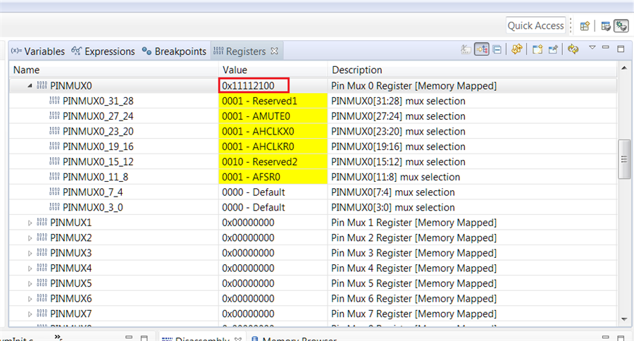

    You can also set a breakpoint after the pinmuxing and look at the PINMUX0-PINMUX19 registers of the SYSCFG0 module in the CCS Registers window. This will give you the details specific to your application.
    For example, "PINMUX0 = 0x11112100;" configures the register as shown below (for C6748). You can modify the registers directly from this window.
    Hope this helps. If you have any questions please let me know.
