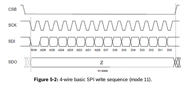

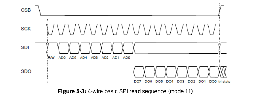

    We are attaching the read write sequence of the device.Along with that we are attaching the SCLK signals.I find one issue that the SCLK we need for 16 bits,but we are getting clock for 8 bits. Is is fine according to you or this is the normal behavior.
    We are not getting the expected value when we are trying to read the device ID of Accelerometer with MCSPI_SINGLE_CHANNEL. Currently we have set "singleOrMultiChEnable = MCSPI_SINGLE_CHANNEL" as we are getting error as was explained in the earlier post. But in the final code we will need to set "singleOrMultiChEnable = MCSPI_MULTI_CHANNEL" as we have two devices over McSPI3.

  • Hi Abhay,
    What is the buf length you are passing to the GIO_submit API?
    Length should be equal to the total number of bytes in a transaction.
    McSPI is a full duplex protocol, so the in Buf and out Buff both have to be of Size Buf Length.
    And the out Buff needs to be pre filled based on the data to be sent.
    In the read sequence, You need to fill the data to be sent in the (on SDI line) at the first byte of the out Buf.
    You need to set the length to 16.
    The data read (sent on SDO line) will be present in the second byte of the in Buf after callinghte GIO_issue and GIO_reclaim.
    In the write sequence you need to fill data (R/W AD6 to AD0 from you diagram) to first byte of out Buf and (DI7 to DI0 in your diagram) in second byte of out buf and call the GIO_issue and GIO_reclaim.
    Please check if you are doing the same.

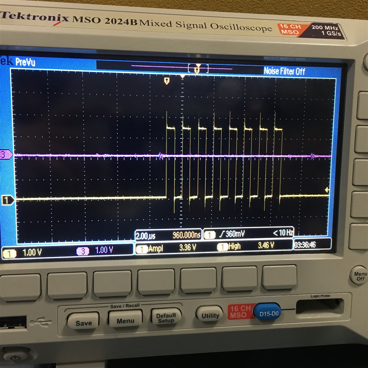

    When you call the GIO_issue, the signals will be sent out, can you probe the clock, MISO and MOSI lines at this point? Check the first byte if the address expected by slave is sent out?
    Prasad

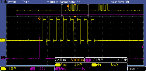

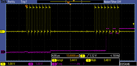

    SPI mode supported is MODE0 and MODE3.
    While checking from CCS  GIO_issue 2nd parameter -> dataParam.bufLen, and 3rd parameter size  are equal to 2
    I am attaching the waveform for CLK vs MOSI  and CLK vs MISO respectively
    Clk vs MOSI (sending 0x80 as Tx):
    Clk vs MISO:
    Is the CLK vs MISO waveform proper??
    When we read the data in inBuf we are getting 0xFA (which is expected) but from waveform you can see that we are getting 0x0A.
    If you see the waveform, the logic level is still high after 0x0A even though there is no clock. Is this OK.
    Abhay
