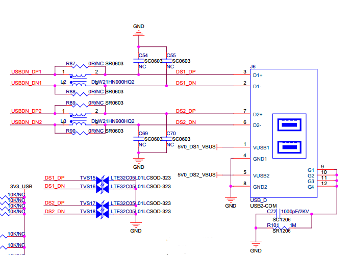

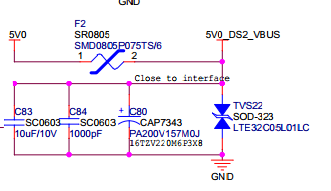

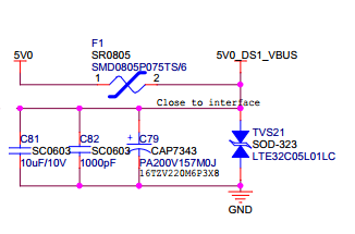

  • Dear Bin,
    Thanks for your reply.  the schematics  is like this.
    When the problem occurs, I pull GPIO_HUB_nRST low, then pull it high, and HUB can re-recognize the U disk.
    The  crystal oscillator is X2——24MHz ,I compared the kernel of 3.2.0, this clock is always there.
    I tried to add  'usbcore.autosuspend=-1' to bootargs, but it didn't work.
    Can you please provide the schematic of the usb portion on AM335x side?
    If the USB0_ID and USB1_ID signal on the last picture above is the usb pins on AM335x, the 1K resister is too much, it should be less than 100ohm.
