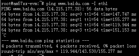

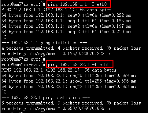

    First of all,we don't change anything in the iamge.
    Secondly we are able to get the ip address for both ports and they can also ping the corresponding gateway successfully.
    At this time I can only use eth0 to ping the website(www.baidu.com)
    Last but not lest,If I let the eth0 down,then the eth1 can ping the website successfully.

    Thanks for verifying that both ports can ping the gateway, this demonstrates what I meant by local network connectivity is working correctly. Since you are able to shut down eth0 and then successfully ping the website indicates that the cpsw driver is functioning correctly.
    The reason when pinging out of eth1 may not work could be a number reasons. Since the ports are connecting and passing packets this is somewhat beyond the scope of TI support.
    The one recommendation I have is looking at the route table which I mentioned in the earlier post, "route". In this table is the default gateway and the gateways used by each port that the kernel is going to use. When you shut down eth0, now eth1 should have the path to the default gateway. The solution could be setting up a gateway for eth1 which is that 192.168.22.1 address that was pinged if I am correct.
    Schuyler
