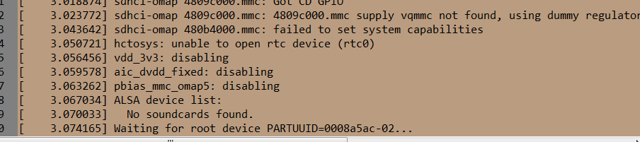

my board is evm-am5728.I follow the steps how to cread a linux sd card,but I can't start my board.
I get into the u-boot, I get this:
1.   setenv board_name am57xx_evm_reva3
      saveenv
      but   board_name is still beagle_x15
2.   setenv fdtfile am57xx-evm-reva3.dtb
      saveenv
      fdtfile=undefind   turn to  am57xx-evm-reva3.dtb
      but  the board can't start
3. I  remove all files (rootfs/boot) ,then  only copy zlmage and  am57xx-evm-reva3.dtb.
4. so I'm sure that I can not change the board_name.  How can I change it ?
  • Hello  gf,
    Seems the EEPROM is broken on your board, due to that the U-Boot defines the board name as beagle_x15 by default. Can you apply this patch, then type make u-boot_clean && make u-boot from the top Processor SDK directory to rebuild the U-Boot and copy the new MLO and u-boot.img to SD card? Later you can reprogram the EEPROM by these commands in U-Boot and these in Linux if its content is erased, or track down the root cause if it is a hardware related.
