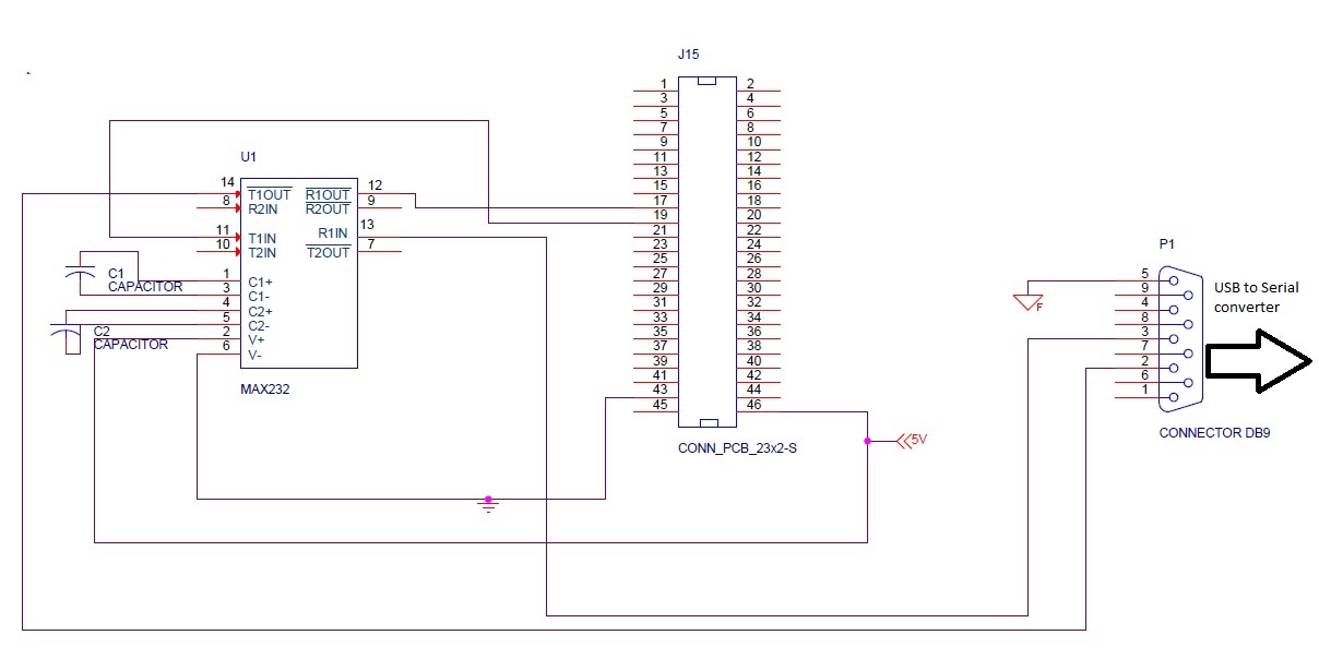

Connection as follows:
1. UART1_RXD ------> MAX232 (R1_OUT)
2.UART1_TXD  ---------> MAX232 (T1_IN)
3. MAX232 (R1_IN)-----> Serial connector ( Tx)
4. MAX232 (T1_OUT) -----> Serial connector (Rx)
MAX232 Vcc is connected to J15 pin number 46
MAX232 GND is connected to J15 pin number 43
Serial connector  GND is connected to J15 pin number 43
Serial connector is connected to serial to usb connector and connected to Laptop

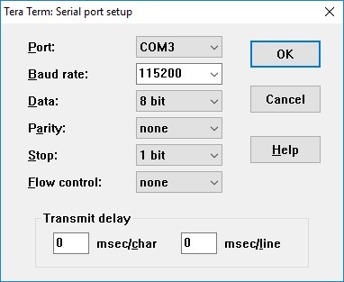

Tera Term settings:
Circuit:

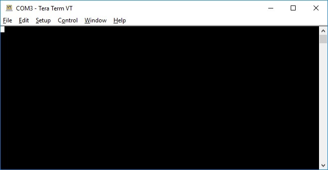

Now I run the program and  I see the result in tera term I could not see anything printing.
Kindly suggest me to work uart1 in LCDKC648 board.

  • hello yordan,
    Thanks for your reply,
    I tried the same code with FT232RL USB TO TTL module. It is working fine.
    UART1_RXD----------->FT232RL (TX)
    UART1_TXD------------->FT232RL (RX)
    Kindly suggest why it is not working for MAX232 what could be the wrong?
    Thanks & Regards
    Navaneetha krishnan
