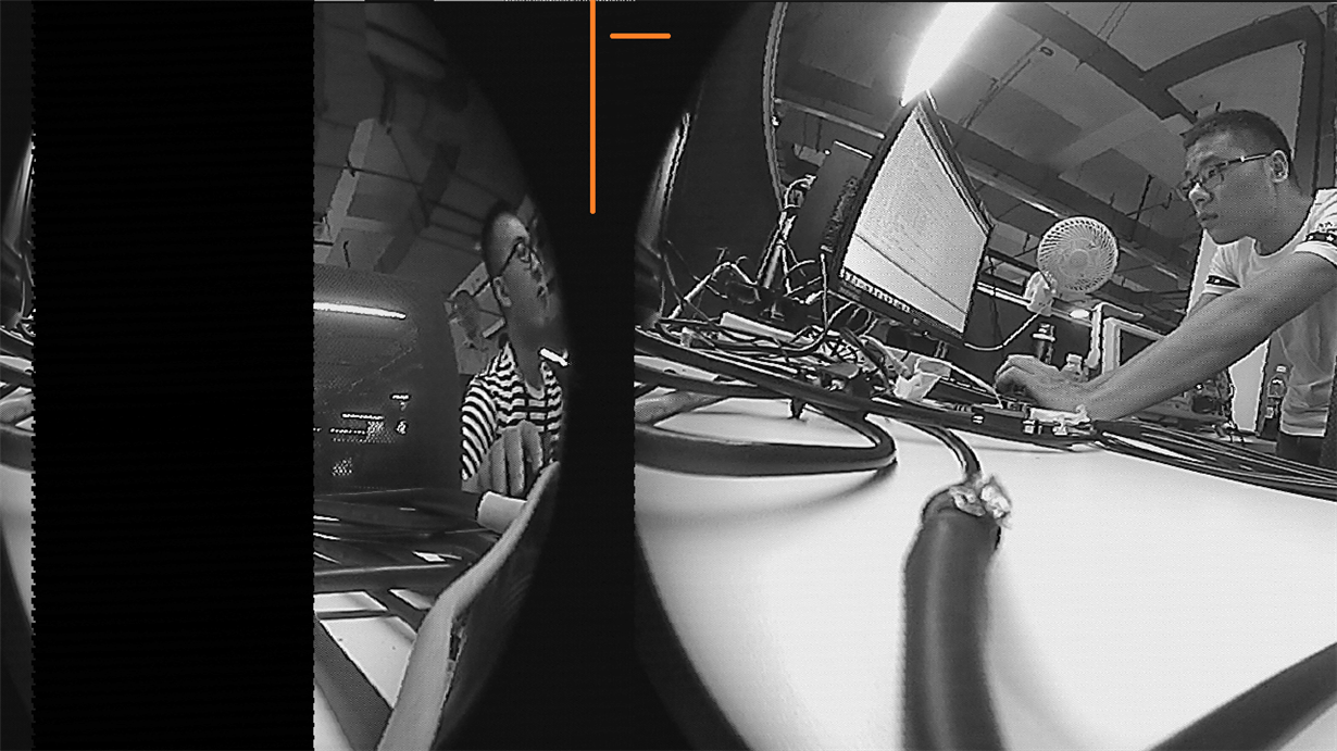

Now we have a projcet using the VIP module to connect the BT656 video.
The path is as bellow:
Analog Camera -> AD device -> J6 VIP port (BT656).
The probleam is that the Bt656 timing form the AD device is not standard, which the filed bit(bit6) in the SAV & EAV is not correct.
BIT7(fixed) BIT6(F) BIT5(V) BIT4(H) BIT3 BIT2 BIT1 BIT0
And the frame captured from the VIP module is error.
Please help confirm that does not the video capture based on the VIP module will check this bit ?
