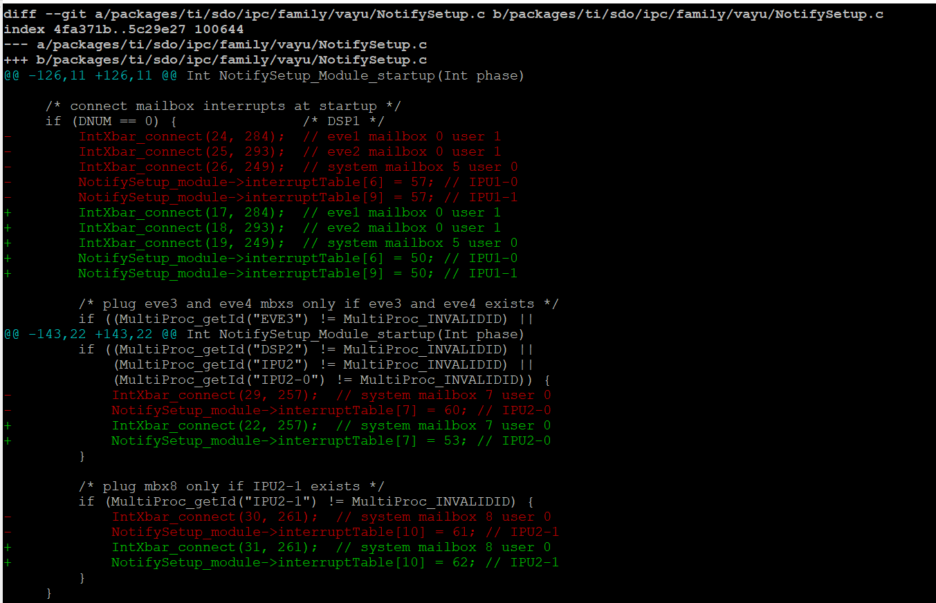

Because notify overwrites GPIO2 Crossbar setting, more details:
so I  want to change the xbar of system mailbox 5 user 0 for dsp1,I modify the ipc_3_47_01_00/packages/ti/sdo/ipc/family/vayu/NotifySetup.c like that:

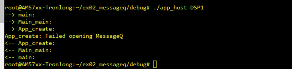

But after that,the messageq is not ok, are there other code should be modify?
BR,,
