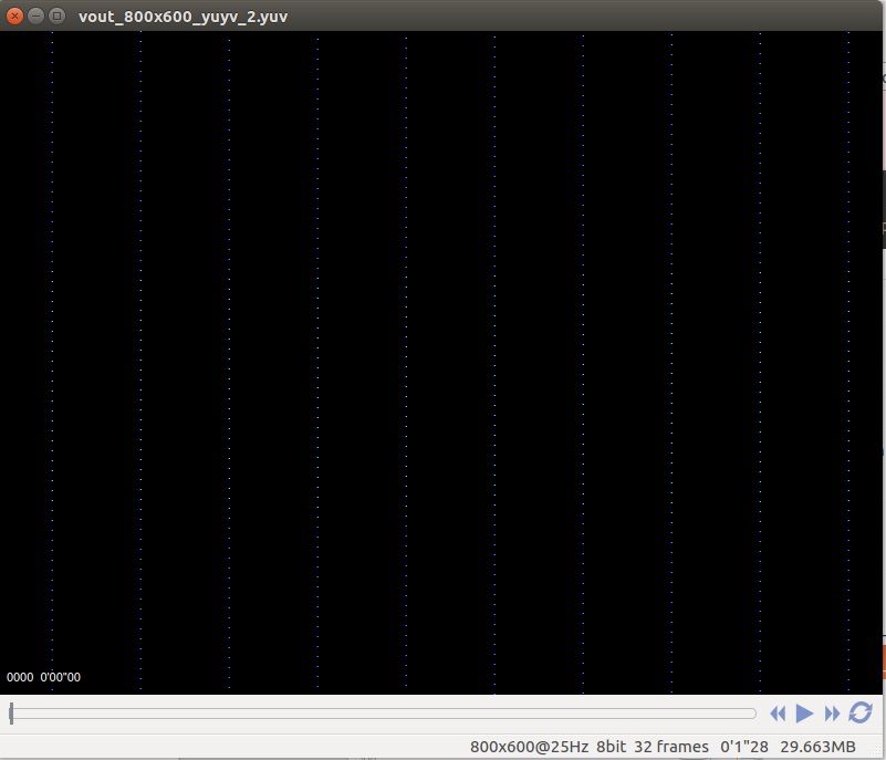

  • Hi Margarita,
    I solved the VIP problem and the video1 is registered. Also, I apply the 「yavta -c60 -fYUYV -Fvout_800x600_yuyv.yuv -s800x600 /dev/video1」command to capture video. Since I don't have NTSC camera on hand, the captured video screen are black. I think it's reasonable.
    2438.dmesg.TXT
