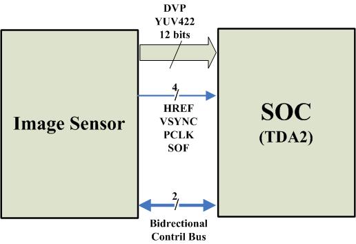

We   refer the ticket    http://e2e.ti.com/support/arm/automotive_processors/f/1021/t/709147   to modify   DVP data width  to 12 bits (original are 8 bits).
But   HDMI output   will  get black screen,   could you please check   for us?
 We   data   flow  as below:
Please find attachment  to get  modify code.

    Note that the display doesn't support 16-bit RAW input.
    Since we are programming 16-bit RAW video format to VIP, the input format to the display needs to be changed to YUV422.
    Also did you get any error message on the UART/CCS console?

    We image sensor output format is YUV422 and DVP 12 bits.
    But TDA2 need separate two component to receive more than 8 bits data. (8 bits/component)
    Now we receive YUV422 frame by DVP 12 bits but we just see half frame from HDMI output.
    (Please refer before create ticket : e2e.ti.com/.../2656778
    As i know VPS storage 12bits data seem like below:
    Component 1(data 0~7) : xxxxxxx
    Component 2(data 8~15) : 0000xxxx (12~15 zero pending )
    but how to setting output 2 component data to HDMI?
    Have any use case or sample code can refer if we needs receive?
    Your understanding of 16 bit storage in memory by VIP is right.
    Did you dump the VIP frame to a file through CCS and then analyze the image is proper with external viewer?
    Note that the DSS supports only 8bit YUV data. So the 16-bit YUV should be first converted to 8-bit data.
    If you really need 12-bit input then, you need to convert this in CPU (DSP). If not then you can configure the VIP to receive only the MSB 8-bit data.
