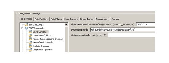

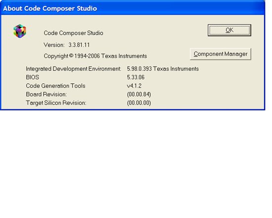

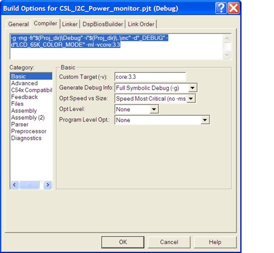

When I compile the code, the CCS gives an error "section .sysmem(0x10000) spans page boundary: not allowed before CPU revision 3.0". If I change the heap size to 0x8000, it works. But if I set 0x1C000, it fails. I know 0x1C000 is still below 128KW boundary. Why does this error occur? How can I increase the heap size? Thanks.
