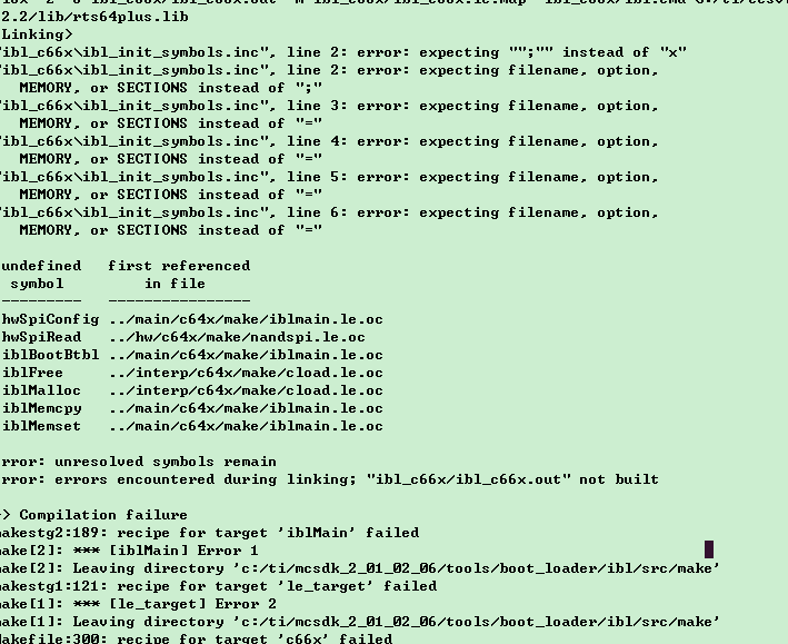

I am building the IBL for c6678
I use MinGW msys 1.0 for the building work.
But I face errors when linking, pls see below picture.
  • can anyone help me? thank you a lot!!!

    1. I use compiler of C:\ti\ccsv7\tools\compiler\ti-cgt-c6000_8.2.2 compiler,
    2. set everything as the build_instructions.txt in folder of ti\mcsdk_2_01_02_06\tools\boot_loader\ibl\doc
    3. as the newest compiler is above 8.2.2, is that the matter for this issue.
    4. I post my setupenvMsys.sh:

    5. the output log pls see below:

  • Luo,
    The IBL code is a mix of COFF and ELF binaries and so you need to use the TI CGT 7.x compiler and not TI CGT 8.2.2 compiler. The Compiler 8.2.2 has stopped support for COFF DSP binaries and when building with ELF, the compiler seems to be including certain assembly files that were written for COFF binaries.
    The simple option is to use older compiler that can be downloaded from ti.com. The other option is to refer to COFF to elf migration guide in the TI compiler and port the COFF assembly to ELF.
    Please note that MCSDK 2.x is a legacy baseline and we are only supporting Processor SDK RTOS based development for these devices on the E2E forums. The documentation for Processor SDK RTOS clearly highlights this need to use older compiler as you can see from here:
    processors.wiki.ti.com/.../Processor_SDK_RTOS_BOOT_C66x
    Hope this helps.
