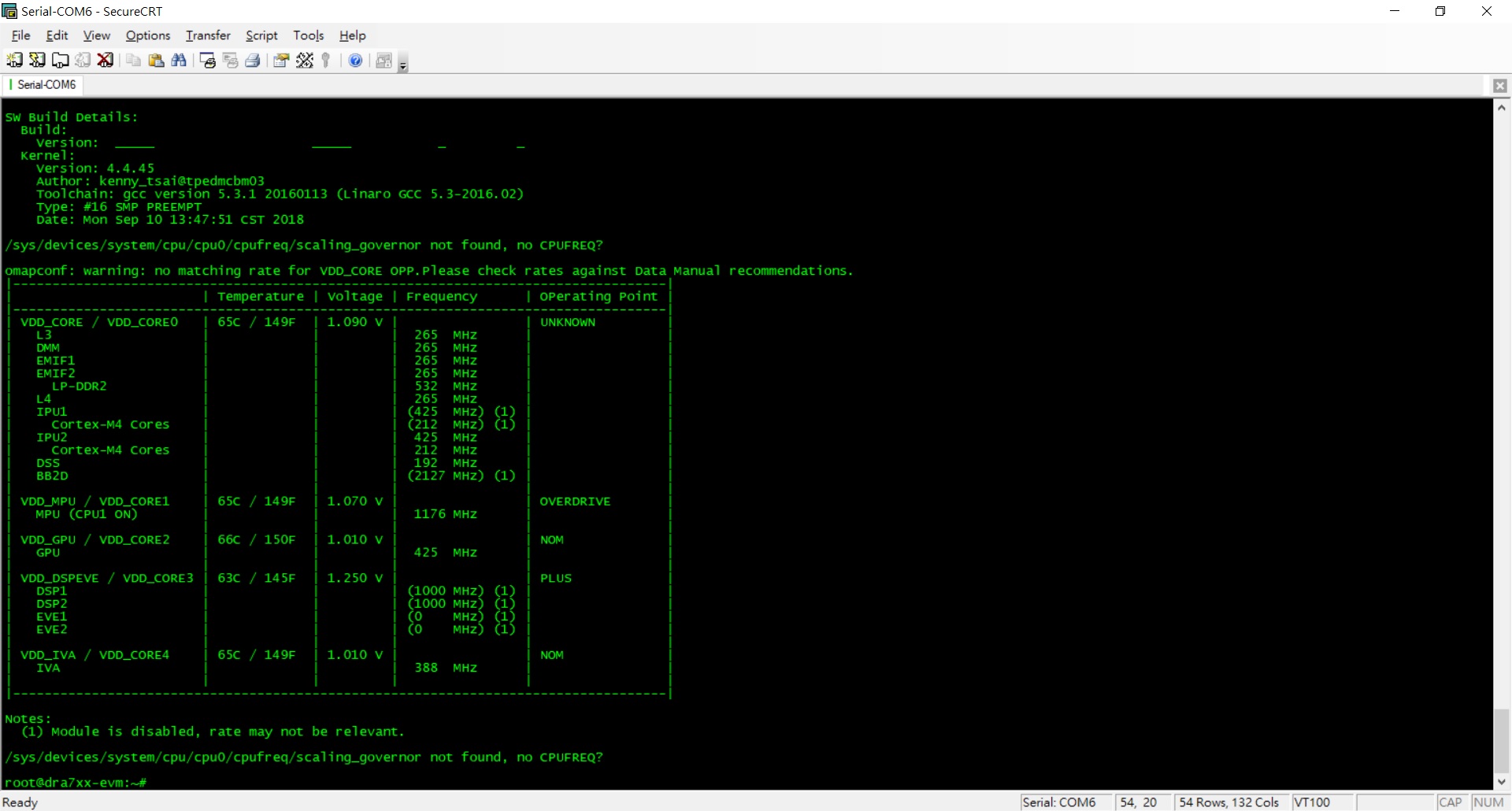

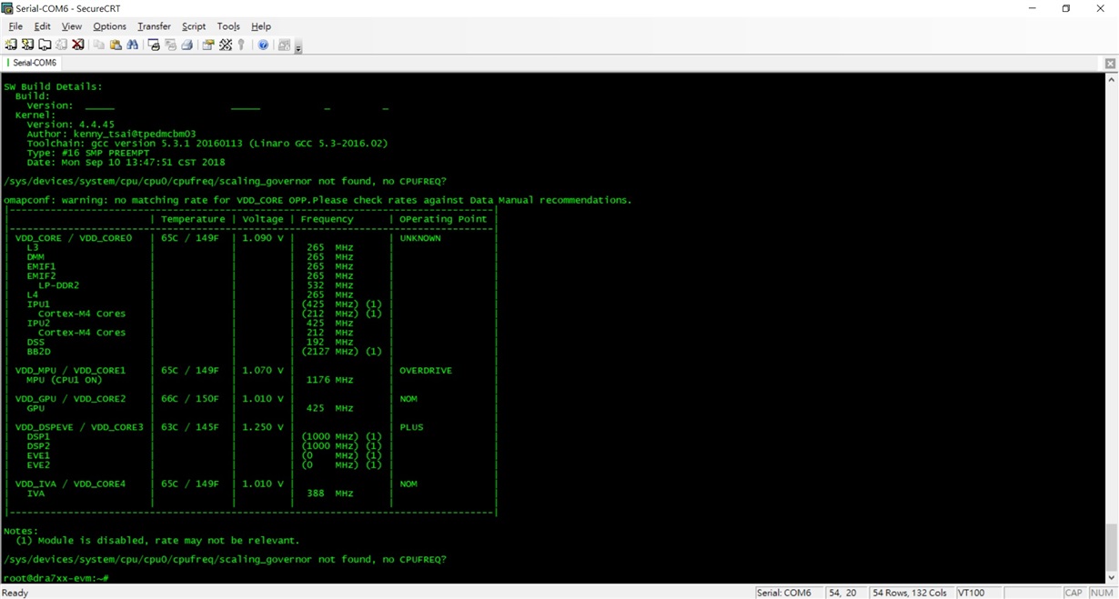

    I use omapconf tool to check my core status after replace new IPU2 firmware, show as below
    It seems EVE still not enable, right?
    Who will set clk for EVE? Is IPU2 ?
    Kenny

  • Kenny
    IPU2 does the CLK, PRCM of EVE cores, so Linux omapconf tool will not show EVE core related details
