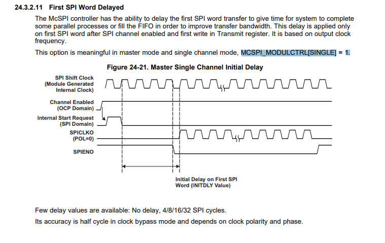

I am trying to send constant and large amount of bytes with SPI from a Linux embedded system -- am335x (Beaglebone: pocketbeagle version). Thing is, I am trying to increase its transfer rate. I am having trouble when sending several blocks of SPI data using spidev (which uses the MCSPI driver). I am sending blocks of 153kb everytime, but I notice a huge delay in between transfers. Here is a picture of a transfer at 15MHz:

I did see a slightly improvement when increasing the word length (from 8 bits to 16 bits). In this document I read that the following could help:
1) Modify INITDLY
2) Keep SPIEN Active Mode (FORCE bi)
The way I see it (judging from what the oscilloscope is showing), the most crutial part is INITDLY. Thing is, I have no idea how to modify these registers! I know I need to modify this in the spi-omap2-mcspi.c but I don't exactly know where.
As I understand in the document, I need to modify MCSPI_MODULCTRL in the mcSPI driver. But again, I don't know where in the code I should modify it (and what to modify!). I'd appreciate any guidance!

  • Hi Luis,
    The intdly_msk value seems correct 0xFFFFFF8F but I would like to note the description of INITDLY field - This register is an option only available in SINGLE master mode, The controller waits for a delay to transmit the first SPI word after channel enabled and corresponding TX register filled. This delay is based on SPI output frequency clock, No clock output provided to the boundary and chip select is not active in 4 pin mode.
    If the conditions above are done but the issues still appears you should keep in mind the userspace processes are not really real time. Therefor I suggest you to try Processor SDK Linux-RT release and compare the results.
