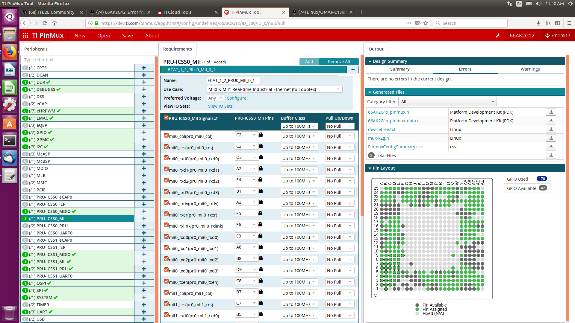

    Maybe I am missing something. Find a screenshot from the .pinmux file (shared by you) loaded in the cloud version of the tool:
    As you can see the output states that there are no errors in the current design. Could you share the steps you use to get the cited PRU_ICSS errors?

  • Hi Frederik,
    On top level pinmuxing (SoC) level, PRU ICSS pads should be configured in the muxmode stated in datasheet. Then there is internal pinmux in the PRU unit itself which allows for additional settings of the pads.
    Probably the errors have something to do with this. I've looped the tool developers to elaborate.
    Yordan
    Yordan Kovachev said:
    Then there is internal pinmux in the PRU unit itself which allows for additional settings of the pads. Probably the errors have something to do with this.
    That is correct. If PRU-ICSS is configured for both PRUx GPI/O signals and PRU MII from Internal Wrapper an error is thrown since such configuration is not permitted. There is no possible way for the tool itself to show these errors in the GUI (it's strictly PRUSS IP specific thing), so we've hardcoded this in the file generators.
    You will have to omit using MII and GPIOs at the same time since they share the PRUSS internal muxing layer. I thought the error message was pretty self-explanatory, is it not?
