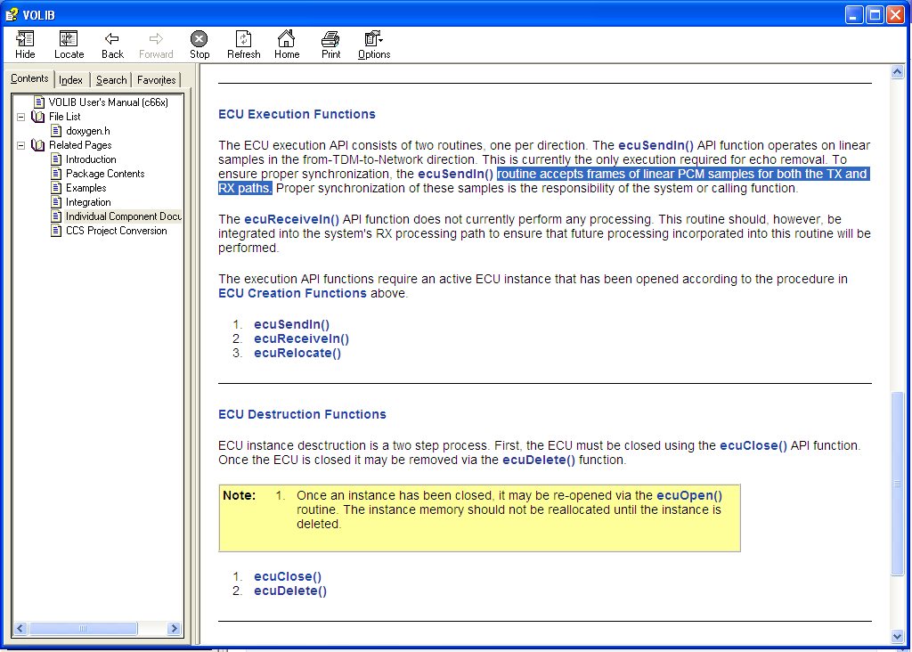

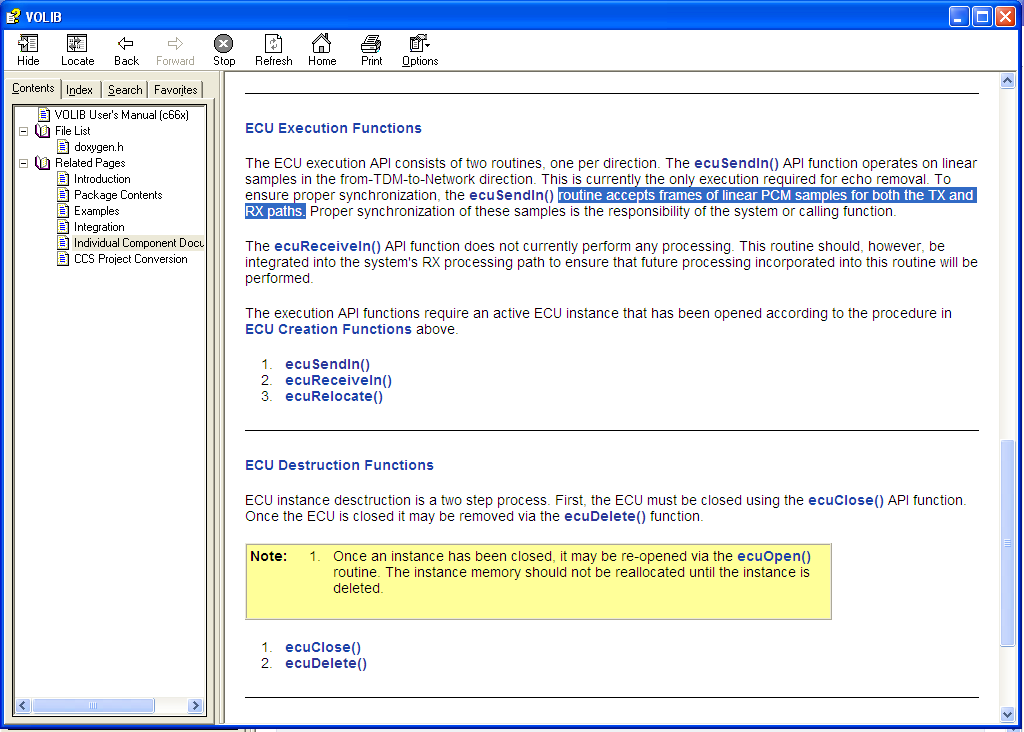

i succeed to removing line echo using ECU with delay line compression enabled. in our project we are using linear samples only and we haven't pcm (alaw or ulaw) samples and encoding sample to pcm consume cpu time !
according to volib_C66_2_1_0_1 chm document ecuSendIn routine accepts frames of linear PCM samples for both the TX and RX paths.
i try to change config:
ecu_inst[IndexStrm].ecuCfg.y2x_delay = 		160; /*One frame default y2x delay */
ecu_inst[IndexStrm].ecuCfg.samples_per_frame = 	10 * 8; /* 10ms default frame duration */
ecu_inst[IndexStrm].ecuCfg.pcm_zero = 		(0x0); //EA:ecu_cmpand 0x55D5->0x0  A-law zero:0x55D5 , U-law zero:0xFFFF
ecu_inst[IndexStrm].ecuCfg.pcm_expand_tbl = NULL;//EA:ecu_cmpand &muaTblAlaw ->NULL
cfgParam.filter_length = SIU_MAX_ECU_FILTER_LENGTH; /* 128ms default ECU tail */
and

echo cancellation work correctly ( 10% echo) but FG filter don't converged (from output of ecuGetPerformance and ecu_CTRL0_BIT_CONVERGED macro )
in this post  said "the PCM samples should be compressed (see muaTblUlawCmpr & muaTblAlawCmpr in the "util" component)"
and in this post  repeat that!
anybody can please confirm ecuSendIn accepts frames of linear PCM samples or chm document is wrong?
i check output of ecuGetPerformance and ecu_VERF_DLINE_COMPRESS macro and seem delay line compress enabled in volib_C66_2_1_0_1 too.
how can i disable delay line compress? (i think ecuSendIn decode pcm sample to linear using ecuCfg.pcm_expand_tbl (sample by sample in loop !!!) and this work consume cpu time too)

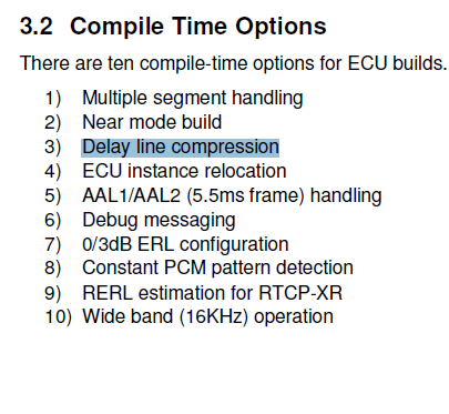

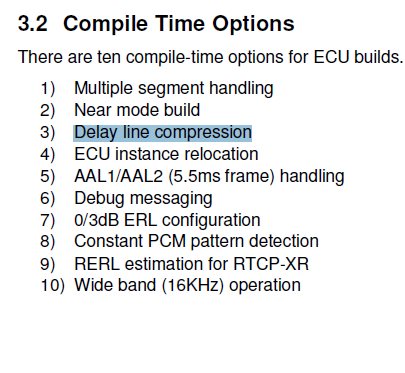

    update:
    i have two questions:
    according to volib_C66_2_1_0_1\packages\ti\mas\ecu\docs\design\ECU.pdf, Delay line compression is one of compile time options.
    1 - according to this post , "delay-line compression is enabled and can't be disabled." i can't find volib/ecu source file for compile and rebuild libs. what's the means of option when i can't change it?!
    2 - what's benefit of delay line companding feature? (i think voice processing algorithms work on linear sample and TSIP or McBSP have hardware companding )
    thanks for attentions
