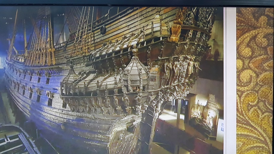

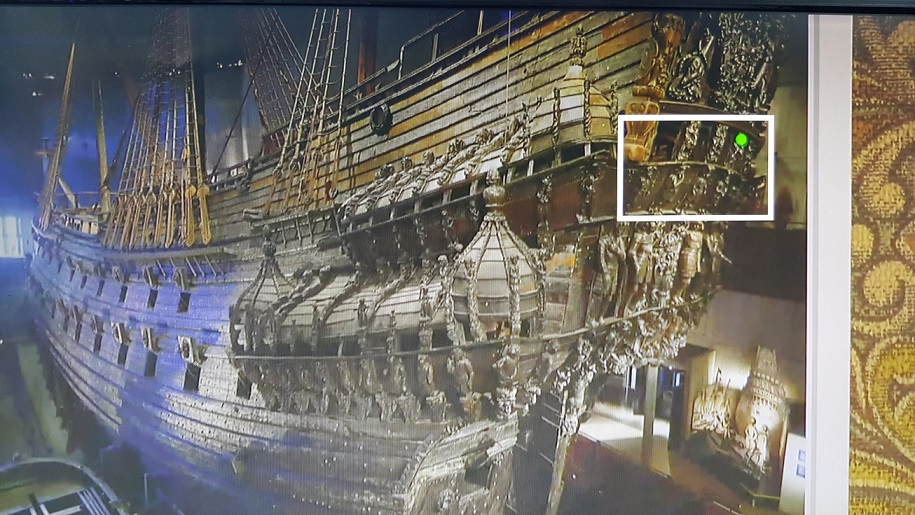

I'm using VISION SDK 3.4.
My goal is to make a chain like below.
dec(M4)->display.
weston(A15)->display.
I found an usecase in vision sdk for each. ( disp_dist_src_display / null_src_decode_display)
I tested both, and it works well.
So, I merged 2 usecase to one usecase using alpha blending.

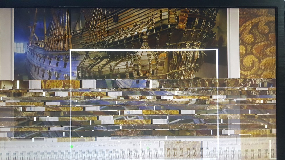

But, displayed image is broken seriouly.
Below is my test sequence.
1. run apps.out. select my usecase.
2. run weston-simple-damage
If I run weston-simple-damage with small size, display is not broken.
But, with large size (weston-simple-damage --width=1280 --height=720), display is broken.
I turned off alphablending. but the result was same.
