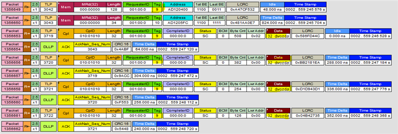

    Great news, our analyzer is up-and-running and I'm actively looking into your issue. Sorry for the delay.
    I have the AM57xx instrumented (acting as RC) with a LAN EP attached. The bus is configured for MPS=128B and MRRS=512B. I've attached a analyzer trace illustrating an upstream read request of 512B (128DW) being serviced successfully. (TLP's 3719,3720,3721,3722):
    I can also execute bursted upstream writes of MPS without issue (TLPs 3049, 3050):
    I'm using the current Linux SDK from TI.COM.
    Please take a look at the traces and let me know if you have further questions.

  • Hi Sean,
    Got an OS build with MPS=256/MRRS=512 from the SW team and recorded the resulting transfers. No issues found for either reads or writes.
    Did this answer your question?
